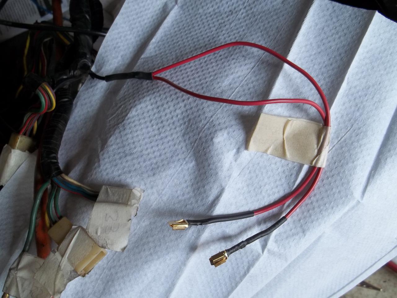

post-18844-14150828337183_thumb.jpg My 71 has a single wire going to the drivers door pin switch and a single wire going to passenger door pin switch. The door pin switches have two wires. Can i connect the two wires from pin switch into the one wire? Both doors are separate (they each have their own single wire) Will it work if it's connected like in pic. Thank you, TimsZ

Connect only one of the pin switch wires and you should be good. Tape off the unused one. I recall that one side actually uses two connects - one for the dome light and one for ??? (key buzzer?) but I have slept and drank too many times to accurately recall which one.
