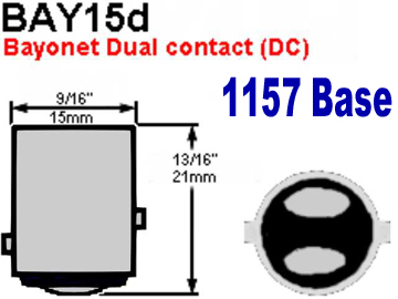

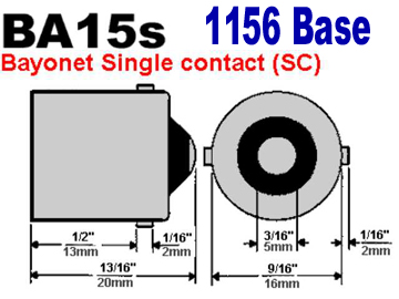

One issue that I believe is happening is that you have an 1156 bulb where you need an 1157 bulb. That is why everything lights up when the parking lights are on.
As you may notice the 1156 has one contact at the bottom, whereas the 1157 has two.
Did your side markers light up with the hazard switch? That would be another indicator of the wrong type light bulb in a socket.
