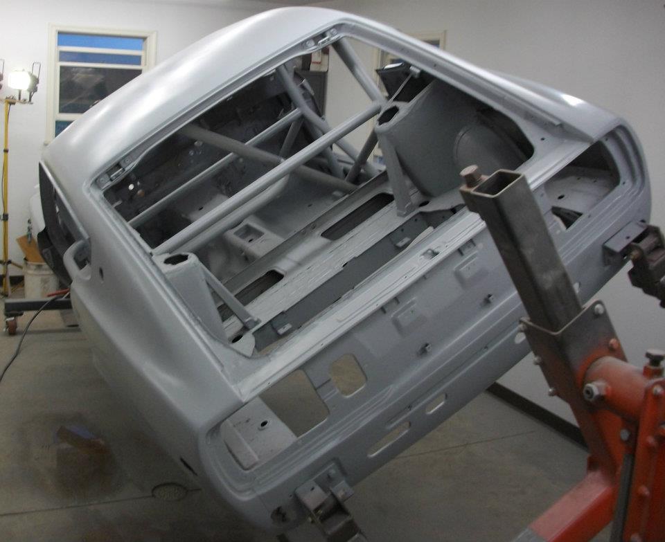

I'd just weld the 2 big holes for the 280Z bumper shocks and then see what has to be done to mount the 240Z bumper. You should be able to make a bracket to mount to the rear panel using the existing holes. Mount the bumper where I attached the rotisserie.
Chuck

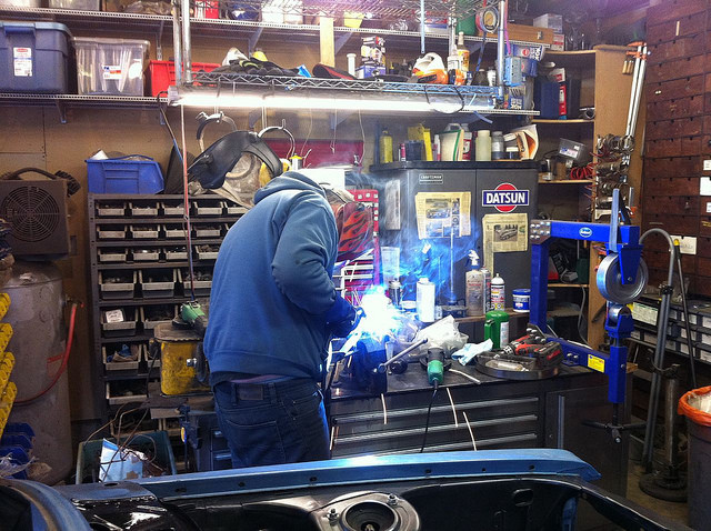

Going to have to go get yourself a nice english wheel and make it curvy. Eastwood has a nice little one. They are SO fun to use and experiment with.
(please forgive the non-Z in the forground. At least it's a datsun)
Oh, I misunderstood. Hmmm...I think I'd just make some nice patches and weld those holes shut. You might have to do some cutting/drilling to eliminate the rear "L" braces where I mounted the rotisserie. I'm not sure what to do with the recessed section where the rear panel welds to the trunk floor. I guess I'd cut that out and extend the floor.
Chuck
