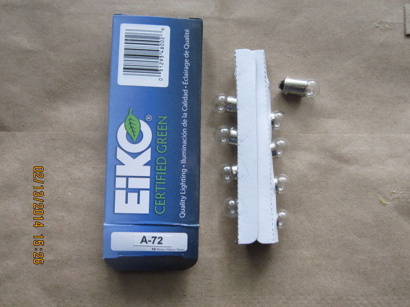

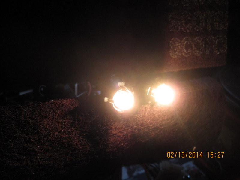

Here are some pictures of the Eiko bulbs, and a comparison. My only "small-form" bulb is labeled LIFE 12V3.4W. The Eiko bulb is labeled 12V4W3E. My camera can't capture the look of the filament, only the size of the glow. The Eiko filament gives a nice wide glow, compared to the LIFE bulb. I don't know if LIFE is a Nissan vendor or aftermarket from the past, I pulled it from an old gauge. So it's old v. new which could also be a factor in brightness. The Eiko bulb slipped right in to the fitting, no issues.
One possible down-side to the Eiko bulb is that it does not have a supported filament. Apparently that can affect longevity in a vibratory environment. Who knows... I won't be installing these for a while. The dim 1 watters will do until I have some reason to remove the gauges.
The Eiko bulb is on the right in the attached picture.
