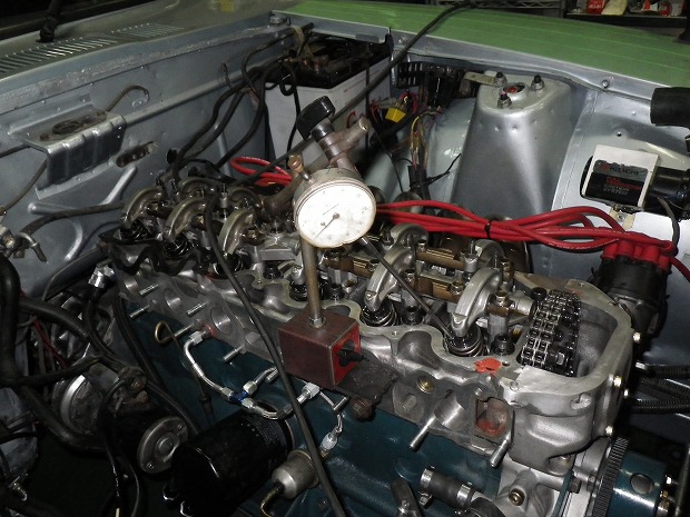

I can't decipher this one? B110TS???,KP61,240ZG,BMW?????(?)?240ZG?CF-L???????
Did he make a new head or is it some Toyota engine... sort of looks like an S30 block underneath but a different timing cover

It's not an LY.
'CF-L' is an acronym for 'Cross Flow-L (series)'. It's basically a single-cam RB head converted to run on an L-gata 'block, with dedicated castings and specially machined components.
Guy who made it ( them ) in Japan has a blog showing the whole process.
( Edit: Sato san's blog is where you found it..... ).

Found this pile of pics: https://www.google.ca/search?q=cf-l+site:sato1511.blog40.fc2.com&num=100&newwindow=1&espv=210&es_sm=122&source=lnms&tbm=isch&sa=X&ei=Vg-mUsL-Fq6gsQSd_IG4Bw&ved=0CAkQ_AUoAQ&biw=1137&bih=527&dpr=0.9
Still trying to figure out how he did it and the details of the required machining and custom parts.
