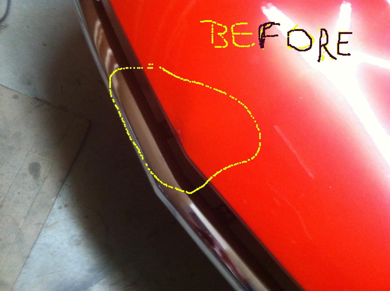

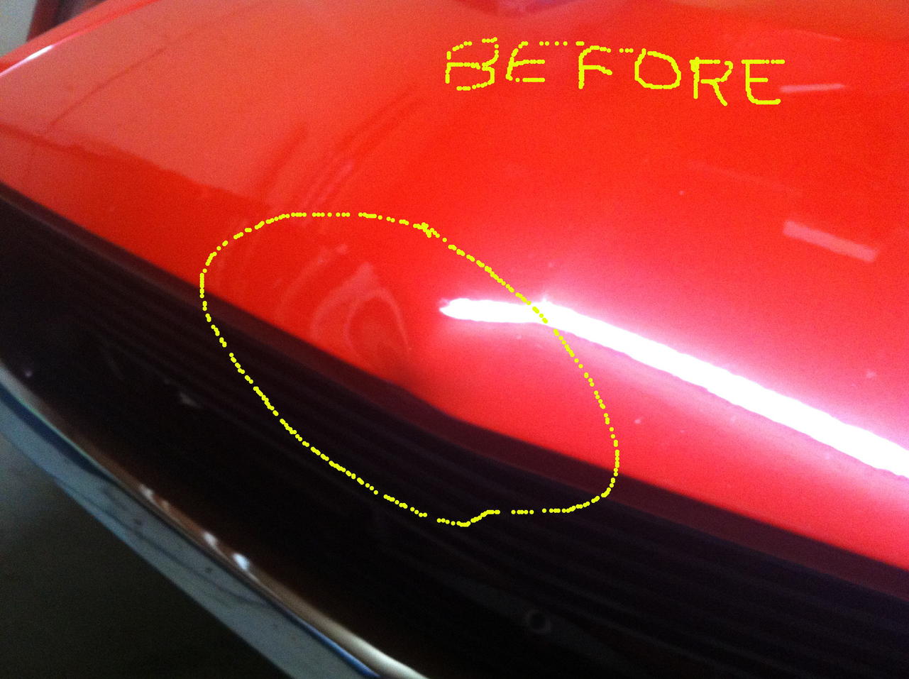

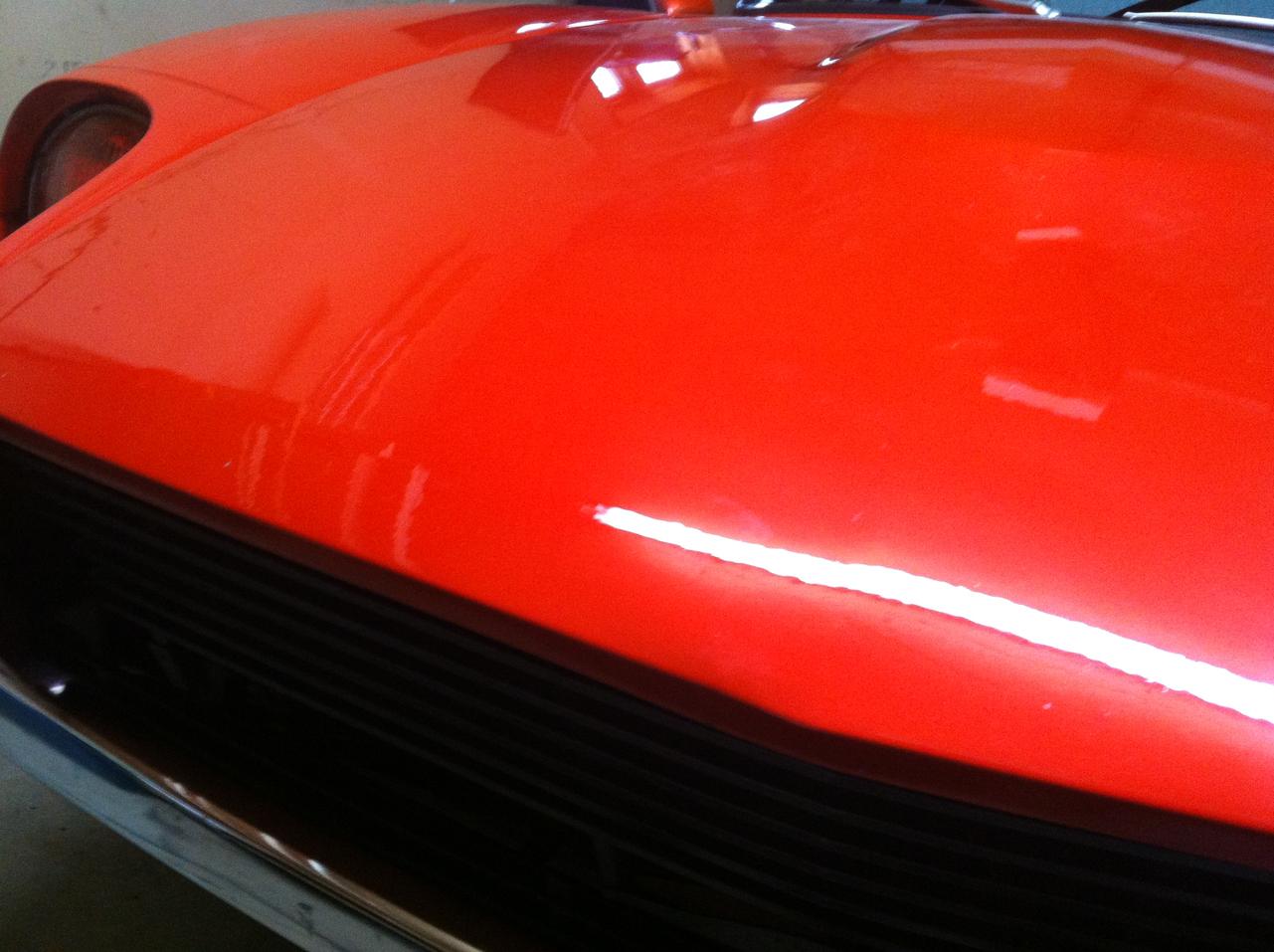

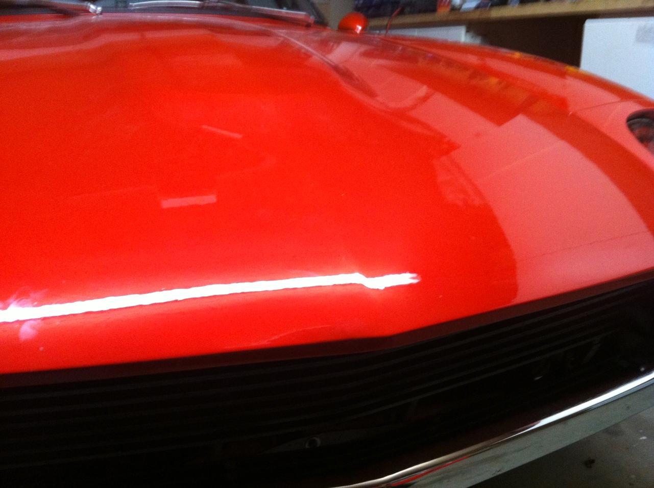

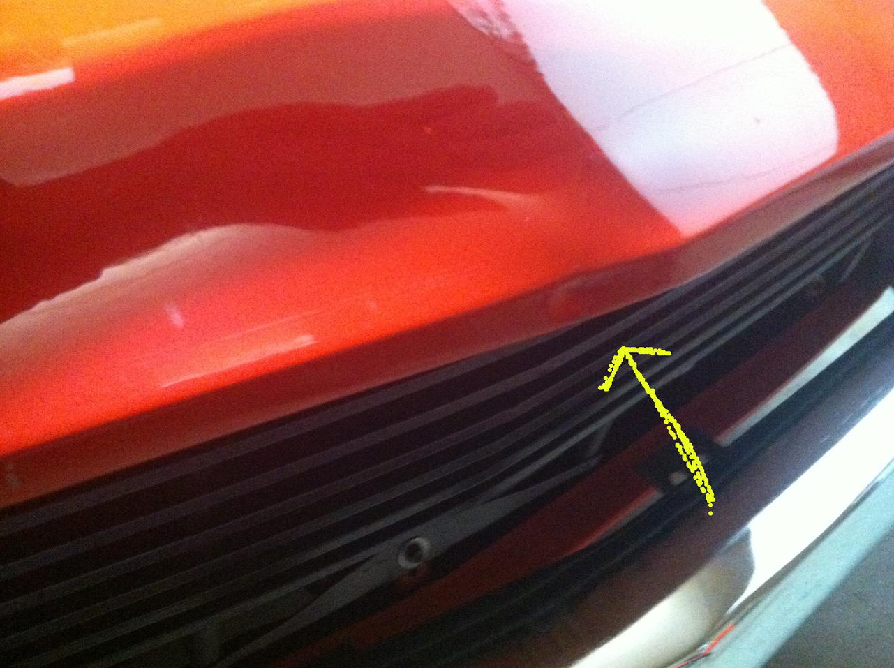

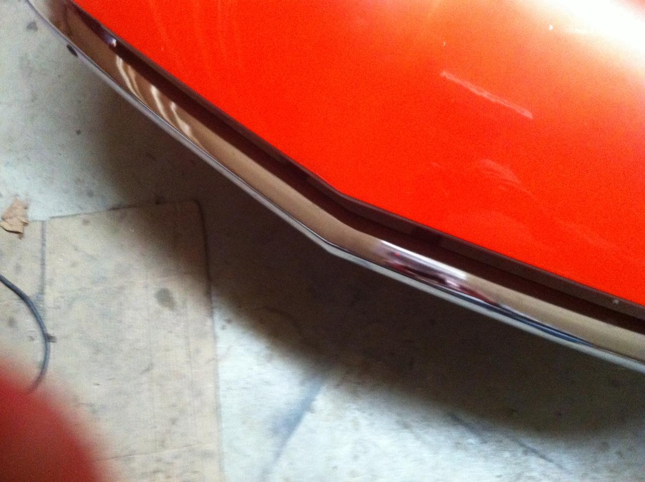

So i took my hood to the guy and i am amassed with the results so i share
So here are the pictures the guy did only taping and streching with rods from beind
he did made 2 holes in the second layer of metal inside the hood to get his rods
in that is it.
took 1 hour and 15 minutes
the last 3 images are after on the pictures ou cannot see the dent at all
and ou have to be very good to see something even while washing by hand.
for me this is like magic
