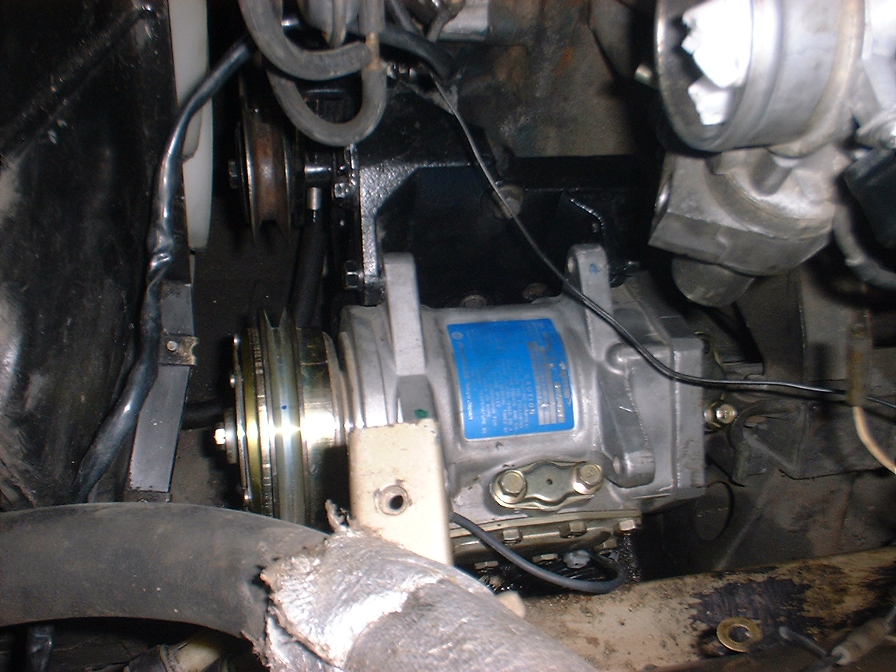

I replaced the factory heater core in my Series I with a VintageAir Mini GenII. Fit neatly in the space without crimping the passenger leg room. Mounted the compressor in the air pump location and used its v-groove for the belt. Works well in our Florida summer heat. Figure to spend about $3K if you aren't doing the work yourself.

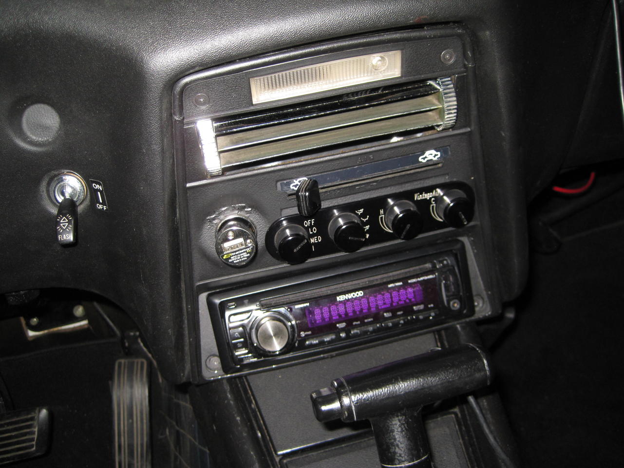

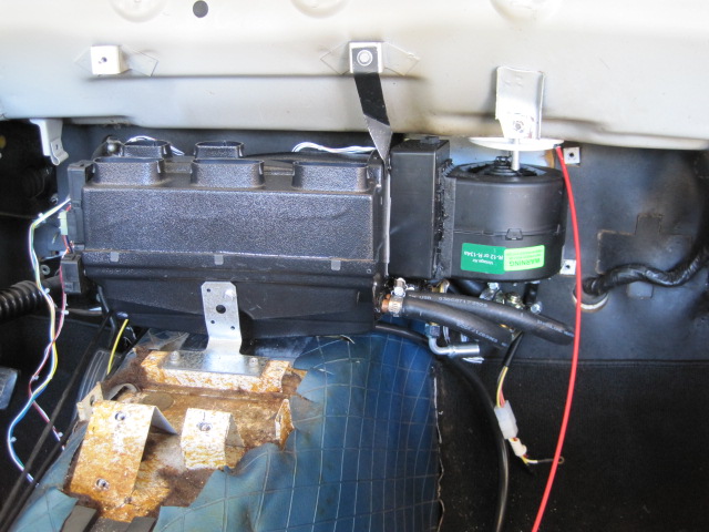

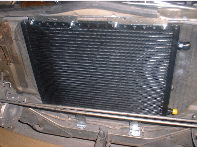

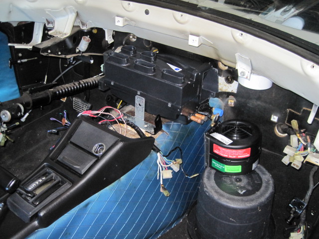

I replace the air handler, modified the center control panel to accept the modern control, mounted the condenser coil and ran the electrics and the heater hoses. Went to a local Z expert for the compressor mount plate, compressor installation and to fabricate the hoses.

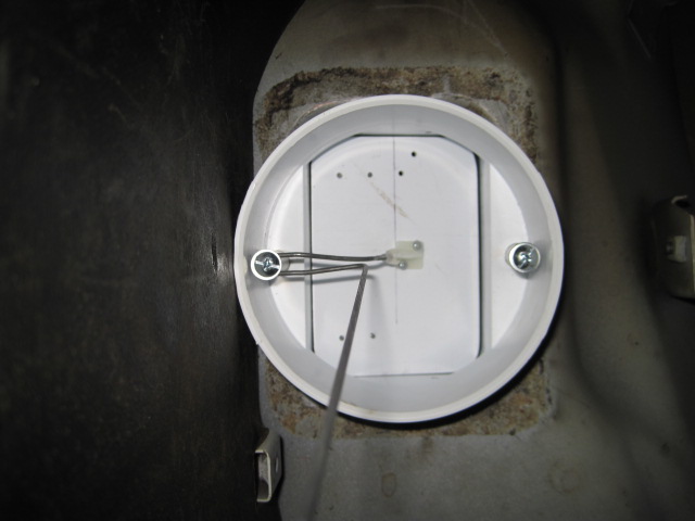

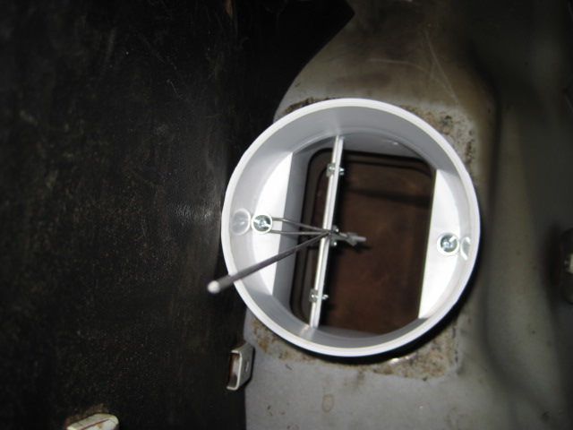

I went to the trouble to modify the air handler fan location to fit under the fresh air vent and fabricated a vent mechanism that dropped down onto the fan for fresh air and with an internal door that closed when the mechanism was raised for the recirculation function. If I were to do it again, I would use the stock air handler and purchase a gate valve used in sawdust capture systems from a woodworking supply store. VintageAir air handlers do not have fresh air venting built in.
I was able to use all the existing air/defrost vents and yielded a clean installation. I did pull the dash to facilitate fabricating the fresh air vent mechanism. I understand you can pull the heater box without pulling the dash.
Routing the heater hoses proved problematic because I bought bulkhead fittings with 90 degree elbows. Doing it again, I would use the existing grommets through the firewall.

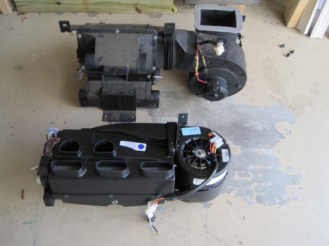

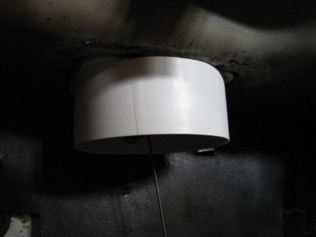

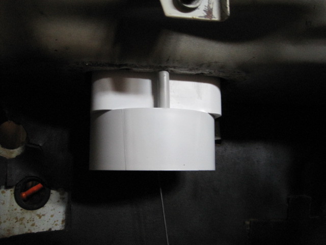

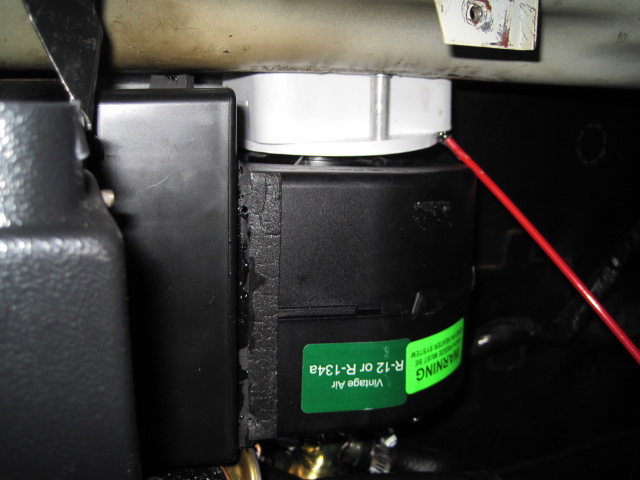

Here are a few pictures of the build.
These compare the GEN II Mini and shows the vent/door configuration.
In order to align the fan with the vent, I inverted the fan and added an air box made from a Radio Shack Project Box. I cannibalized a lever from the OEM heater control to construct the fresh air - recirculate control.
One point I should make, modifying the air handler probably voided the warranty. If I were doing it again, I would have used a woodworking dust exhaust gate and built an air box that moved with the gate leaving the air handler stock.
