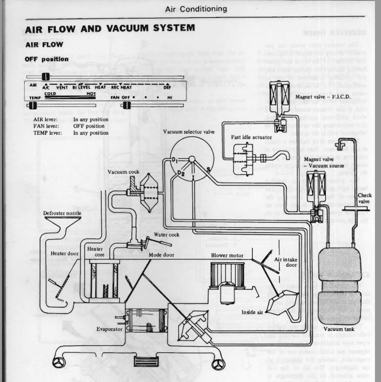

Check the vacuum lines to the white bottle under the hood. The valves for the heater flaps are vacuum operated. Pretty common for old tiny vacuum hoses to crack and break off. The vacuum is controlled by solenoids (Nissan calls them magnet valves). It's all described in the Air Conditioning chapter (Nissan calls heating AC also).
Thanks, but no white bottle. I have read the flaps are vacuum operated but cant find any vacuum hoses going through the firewall to the interior. Also I have checked all vacuum hoses arount the thermostat and intake and replaced one but still no heat.
