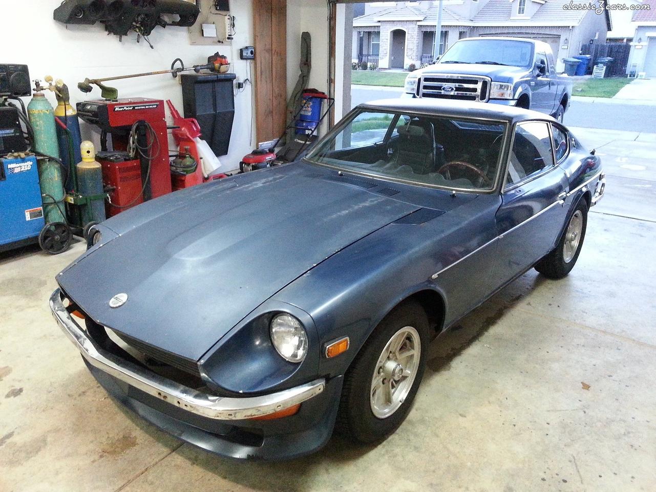

Here's how she looked when I put her back on the road after over a decade of slumber.
And after a little buffing and having driven her for a couple months.
getting tired of not making much progress on shining up the paint and removing the years of oxidation I got myself a 7" buffer and a nice wool pad, I think she's starting to look pretty good all things considered.

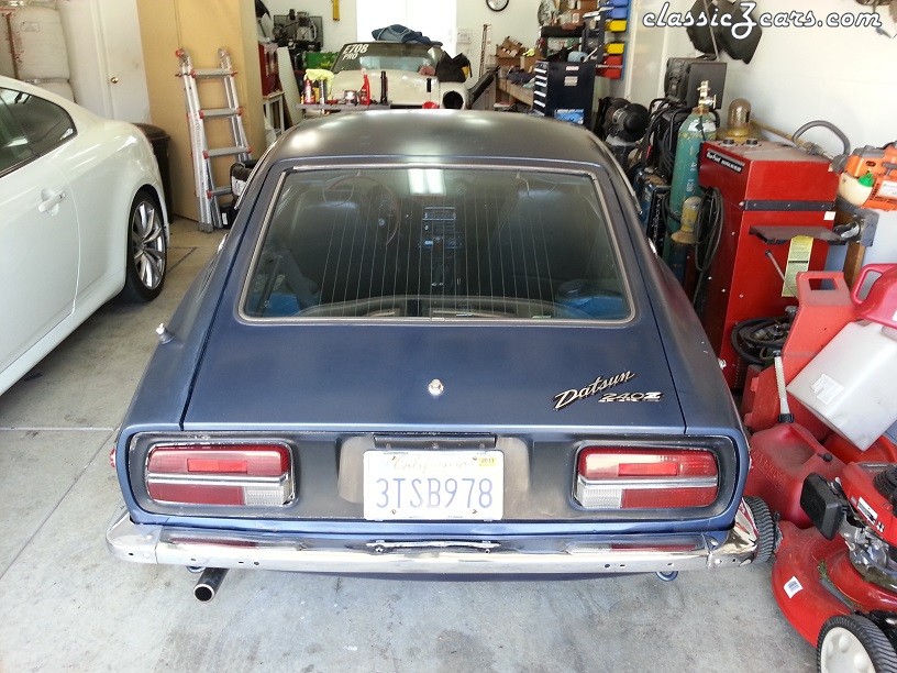

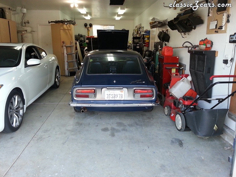

And today I got around to cleaning up the taillight surrounds and painting them. Color's not 100% correct but I think it looks waaaaaaay better! First pic is BEFORE and second is AFTER. Also added the rear deck emblems a couple weeks ago.
Pretty happy with the way is turned out, although I found out my license plate light assembly is pretty much shot. Two of the nuts are broken out so I had to JB Weld them back in to put it back together. Have to put that on my list of things to replace now.

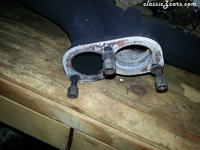

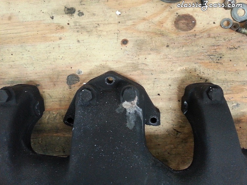

SO now for the bad news, the engine developed a coolant leak into #4. Not terrible, but enough to put a good bit of water into the cylinder on shutdown. Funny thing is it didn't push any exhaust or compression into the cooling system and appears to not leak while running. Only when shut off. Soooo, I started pulling the top end apart to see what I could find. Shame too because the engine has only about 1200 miles on it. Great compression across the board and oil pressure but the top end needs help.
Water leaking out of #4 exhaust port....

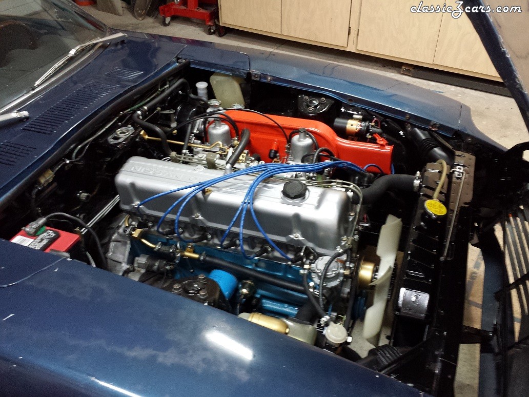

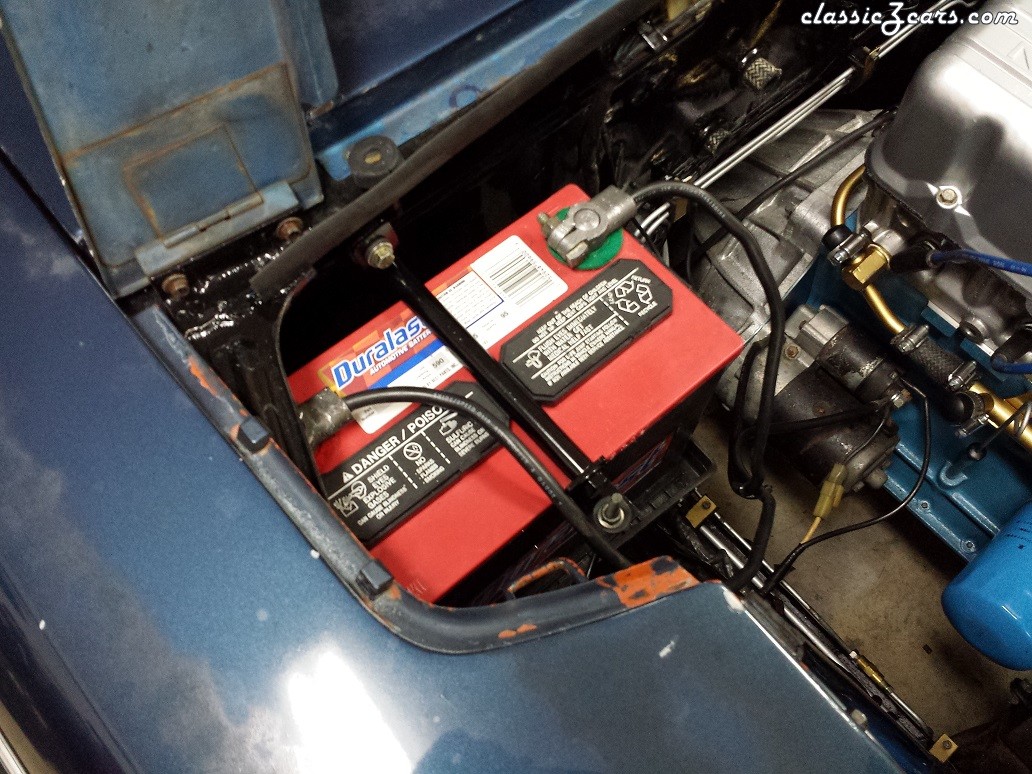

Replaced the head with a Maxima N47, that is in really good shape. Had to notch the block for the valves though. While I had everything apart I rebuilt the carbs, refreshed the air cleaner, radiator, intake and exhaust manifold. Runs like a champ now, but only like 10 miles on it yet. Also fabricated a pretty bitchin battery hold down seeing as I don't have the correct battery at the moment and the stock one sits all caddywhompus on it. An hour and few cents worth of scrap metal I had around the garage with a splash of left over black engine enamel and voila.... sweet battery hold down.

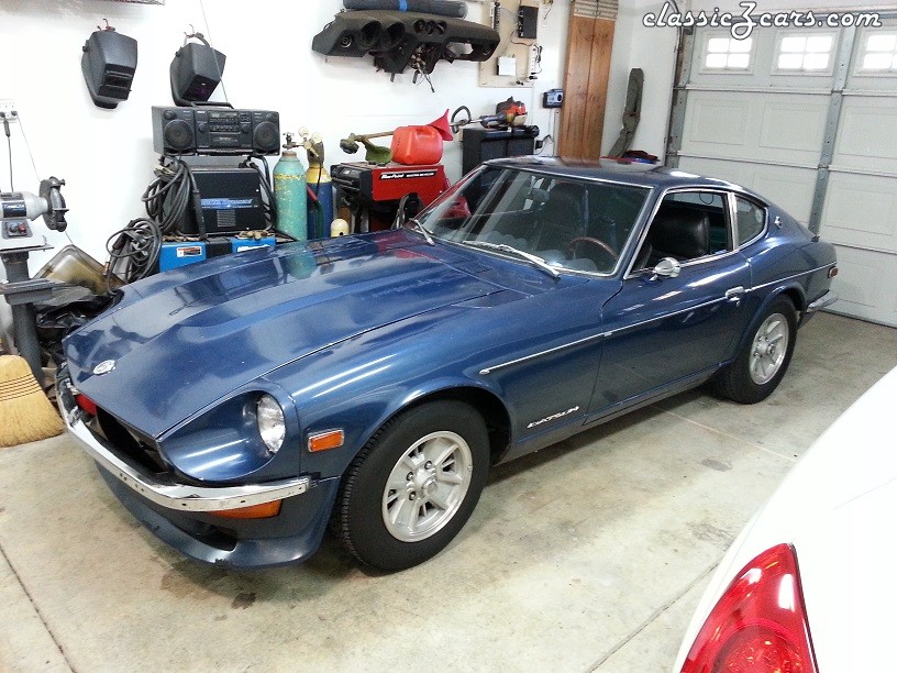

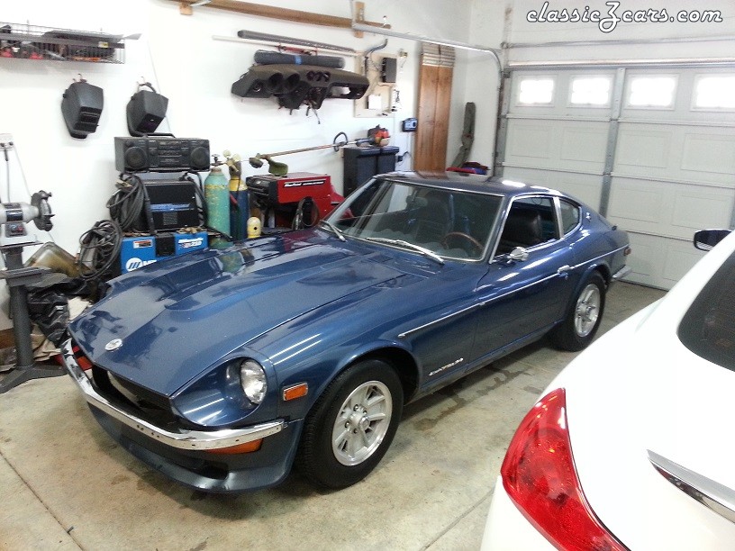

All back together and ready for a Sunday drive:
Pretty Engine:

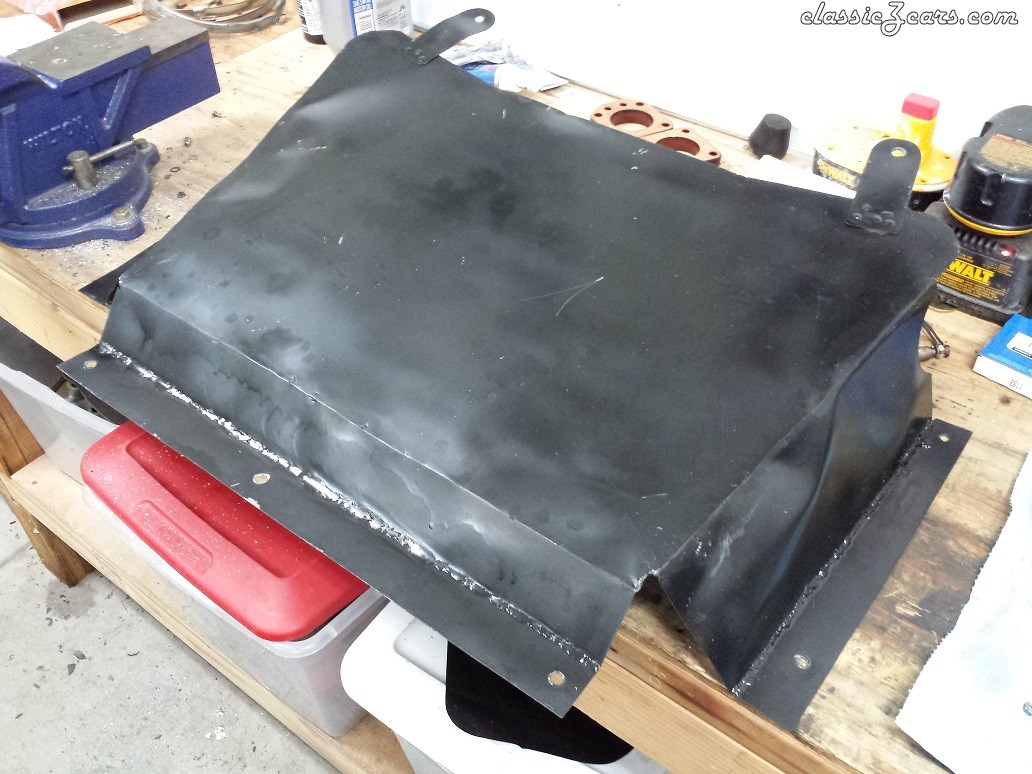

And the splash pan I fabricated for my race car that will be donated to my 71' until I find the real deal:
