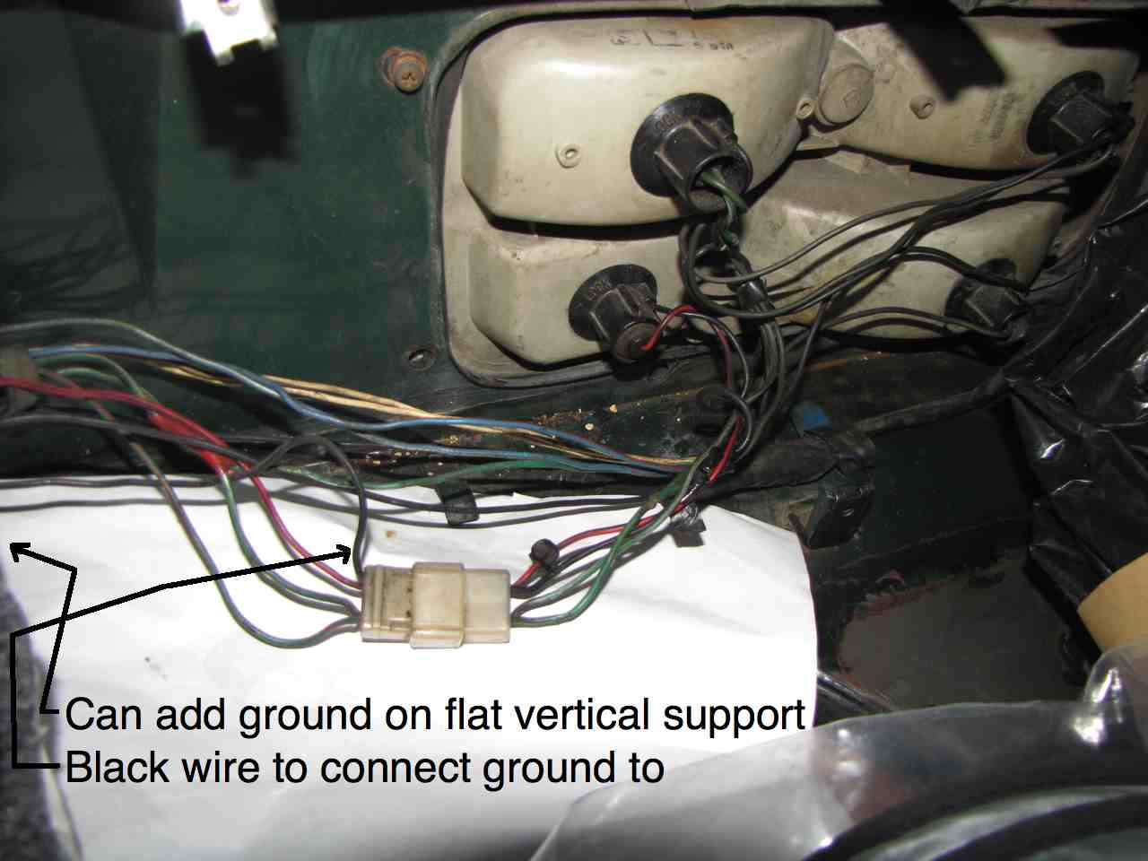

On my '70 model the ground for the tail lights appears to be where the green arrow points on the attached picture on the floor on a piece of metal that sticks up about an inch. On my 72 parts car all of the wiring, nuts and bolts have been stripped, I can't see an obvious separate place for the ground as on my '70 model. I notice on the '73 FSM electrical schematic the ground for the tail lights is shown near the fuel sending unit. I know there is no guarantee that that means the ground is near the tank sending unit but it might be a hint. The ground might be underneath the car on the sending unit. If you can't find a ground you could add one by connecting one end of a wire to the black wire on either tail light connector on the car harness side of that connector, see picture. The other end of the new ground wire would connect to the metal car body perhaps where the vertical support is in the middle (after hole is drilled and paint scraped off) with maybe a bolt, nut and lock washer to make it very secure. The wire would go to a "ring connector" or whatever they call those which would fit under the bolt. Or you could temporarily make this connection to verify it solves the problem.
If only one tail light is behaving that way the connector for that tail light assembly might be cleaned, especially the two halves of the connector for the black wire.

Ground location on my '70 model (hopefully this wasn't added by a PO)
New tail light ground connection:
