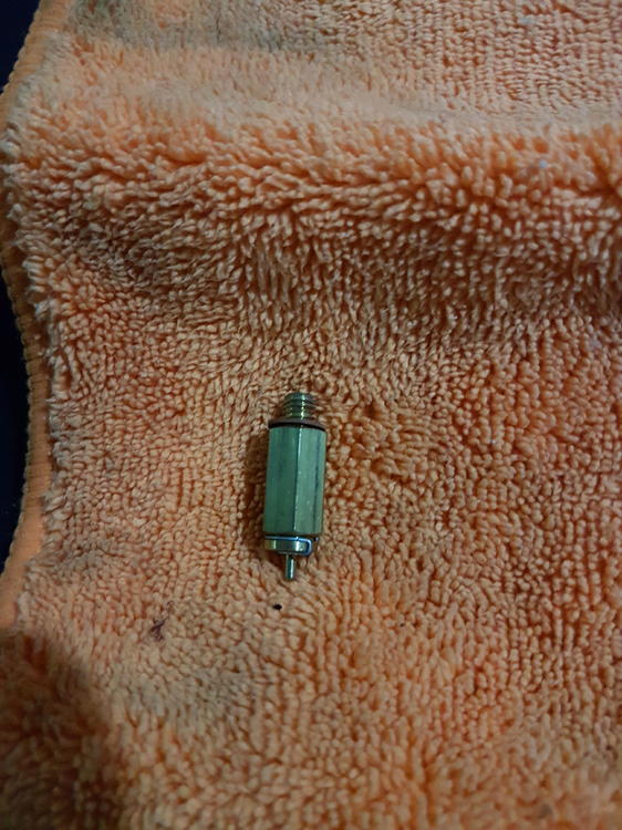

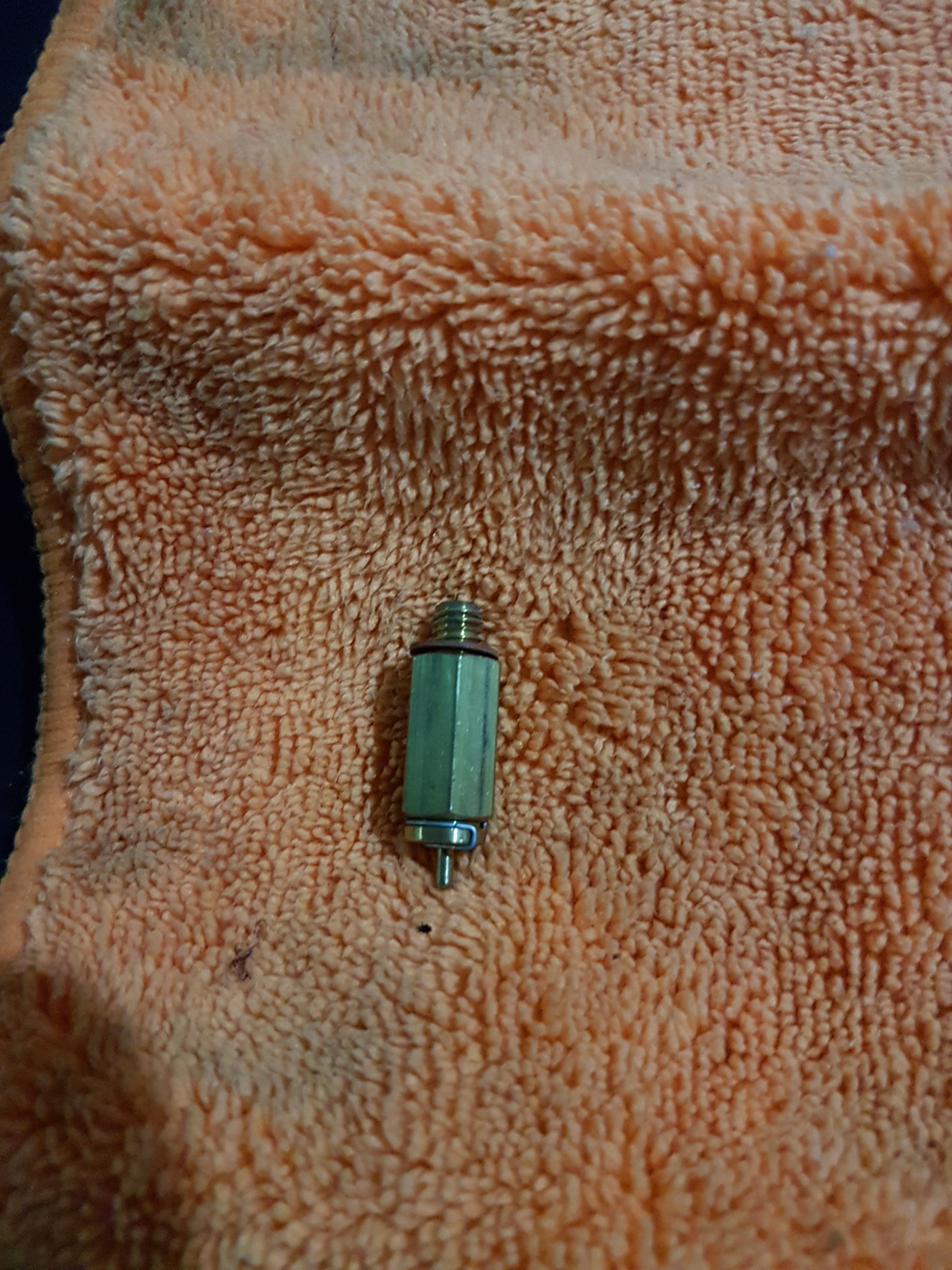

Thanks for your kind advice. I might have screwed the float level either on the front or rear carb as the engine still backfires at the carbs intakes at 3.5 turns clockwise. I am not certain of the history of the needle valves and maybe they are not in the correct working order.
Doesn't seem like needle valves would be causing the problem -- there are adjustments built into the carbs that can compensate for minor variance. Nice to have fresh parts for a thorough rebuild, but if the needle action feels smooth and even for both, cross them off the list and go back to the usual suspects.

I experienced ocassional fuel bowl overflow.  I attributed the issue to less than optimal float tang geometry.  The modern valve stem design does not glide on the tang as easily as the original design as has been said in this thread previously.  My solution was to remove the sealing washers from the base of the fuel valve body to lid/inlet port.   Once I did that, tang to valve geometry is improved and issue went away.

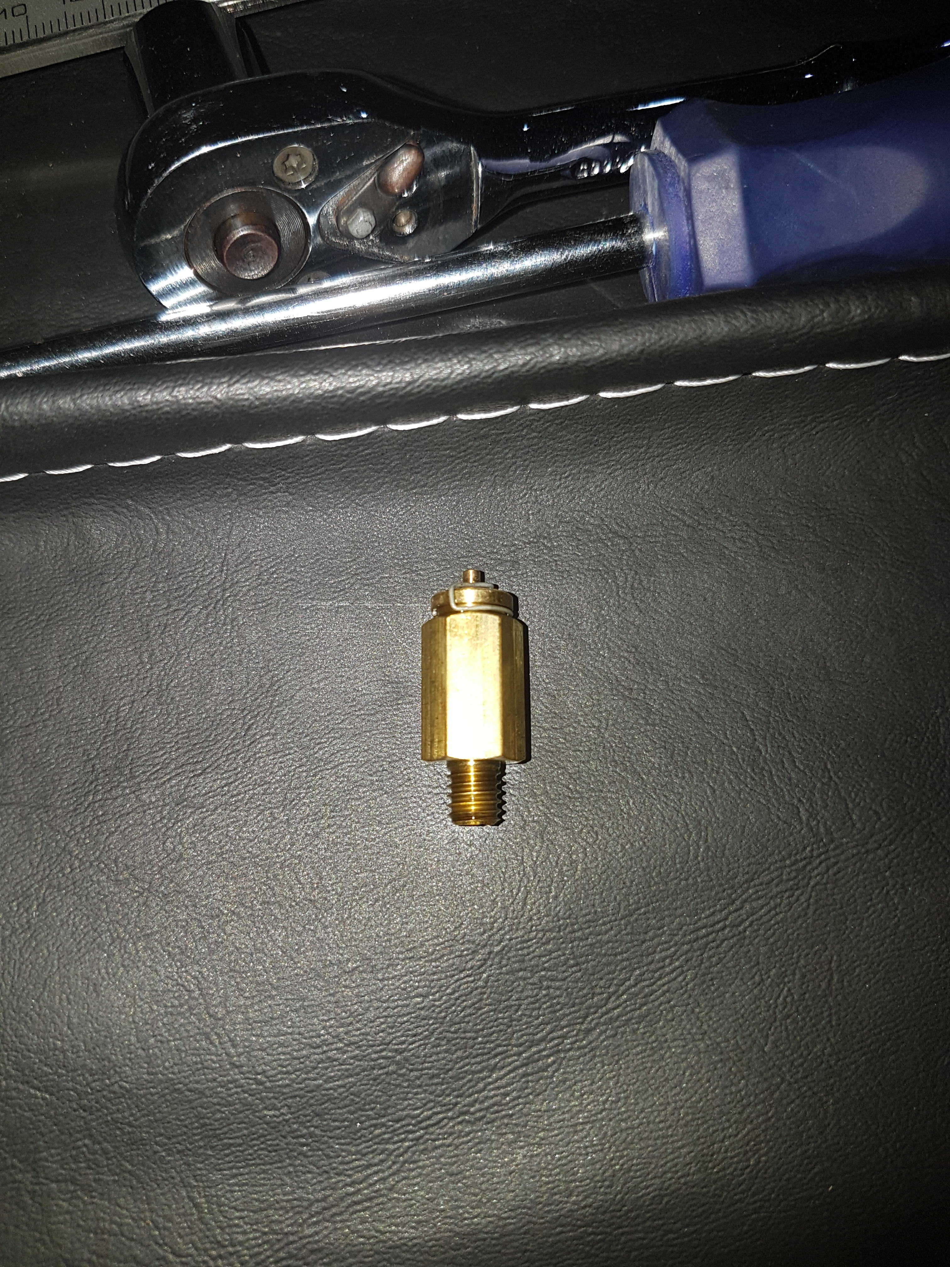

On 2/16/2018 at 8:21 AM, David F said:
Not sure what you are talking about, so I think not.  needles look like any other to me.
You answered my question from earlier, thanks.

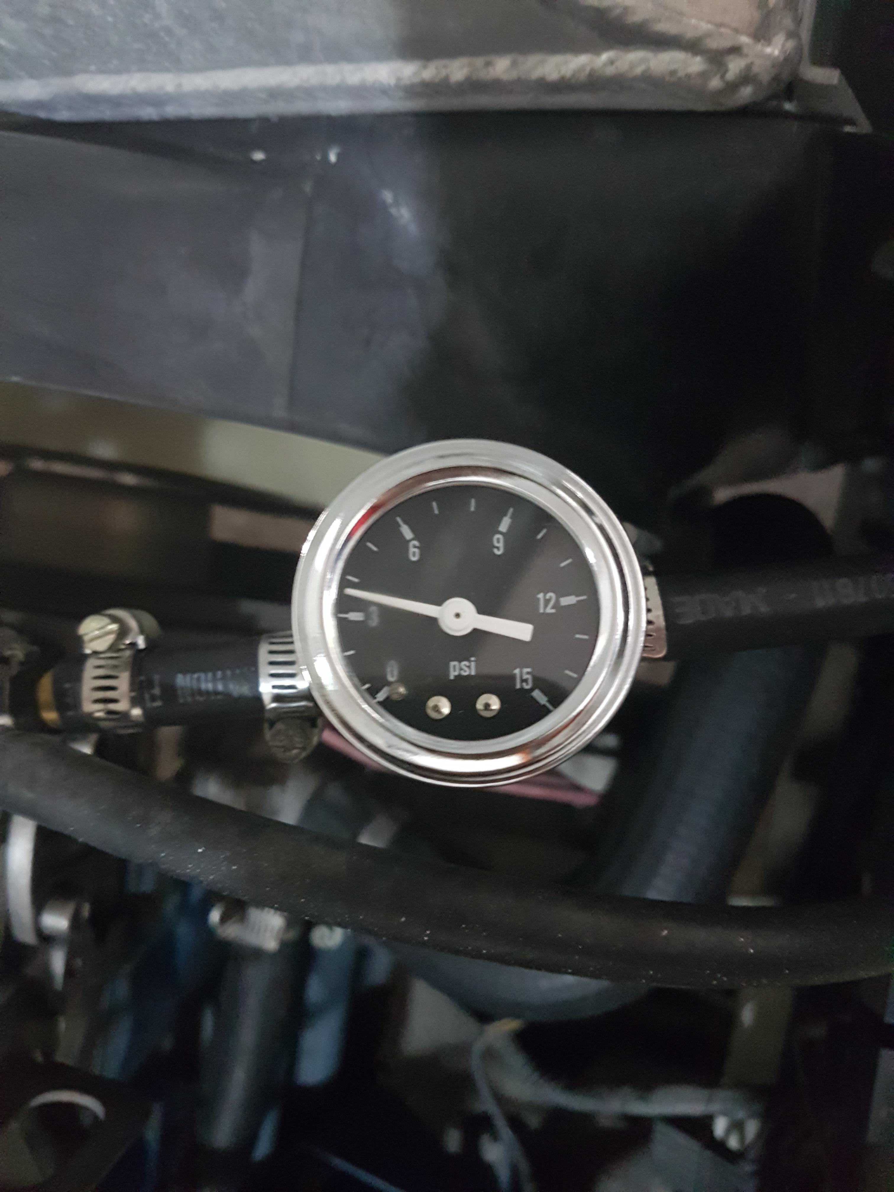

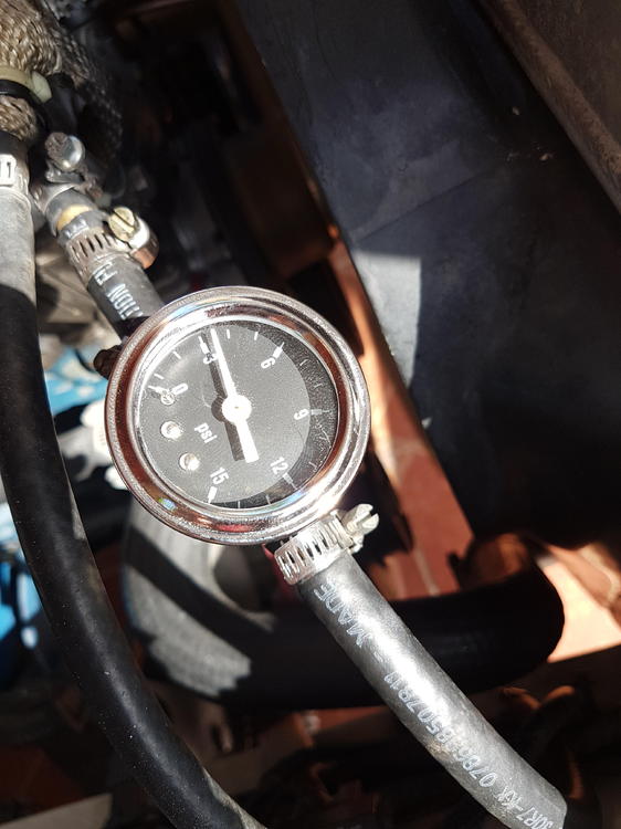

Im reall concerned on the difference on the reading of the psi of the former pump vs this new one which is the same model.  My mechanic did installed a  restrictor after the fuel filter before the carbs. Should i remove it? Its the bronze color one between the clips.
Edited by jalexquijano
1 hour ago, siteunseen said:
That's a reducer not a restrictor, for a step down on hose size, it won't affect the PSI.

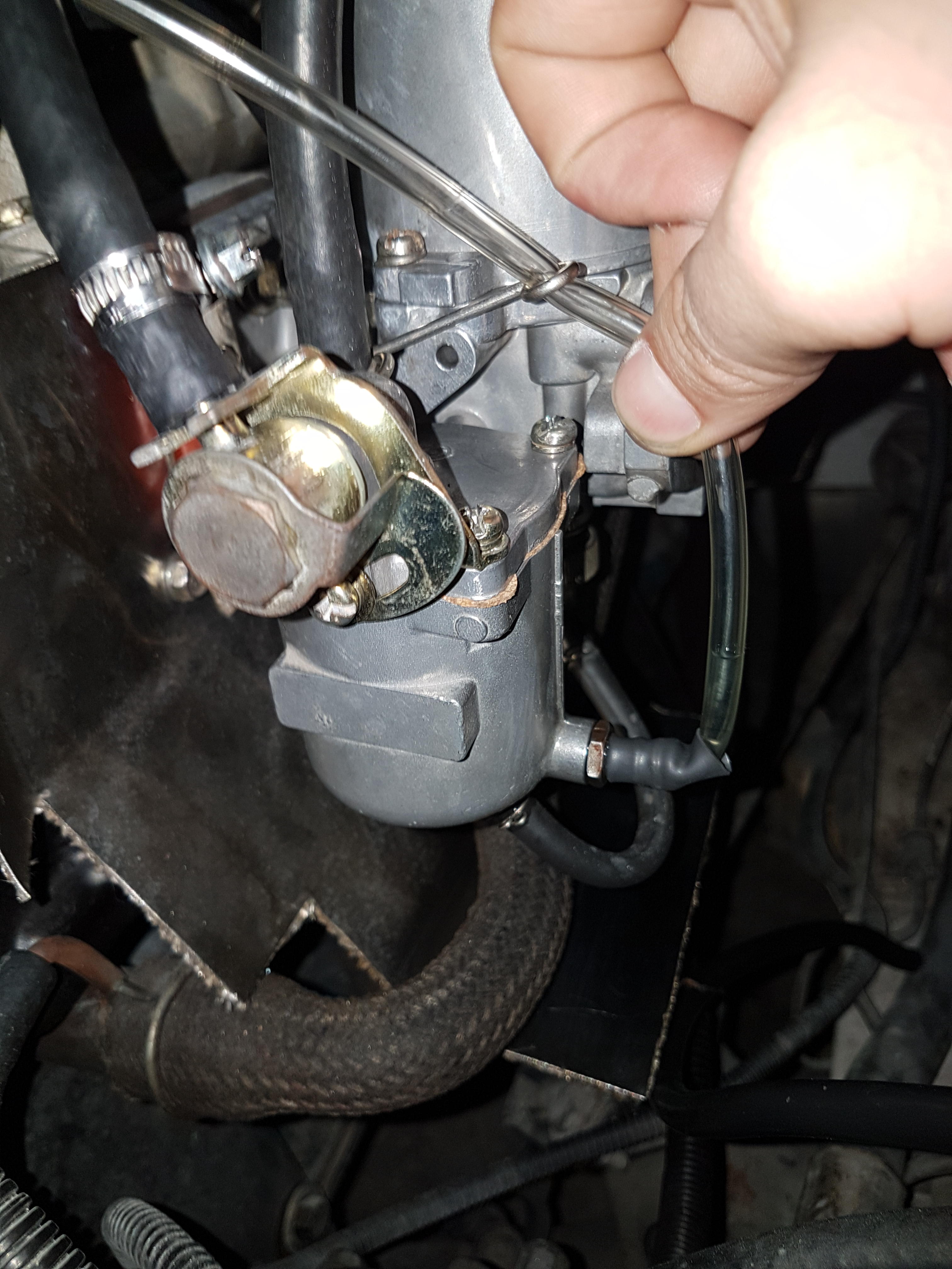

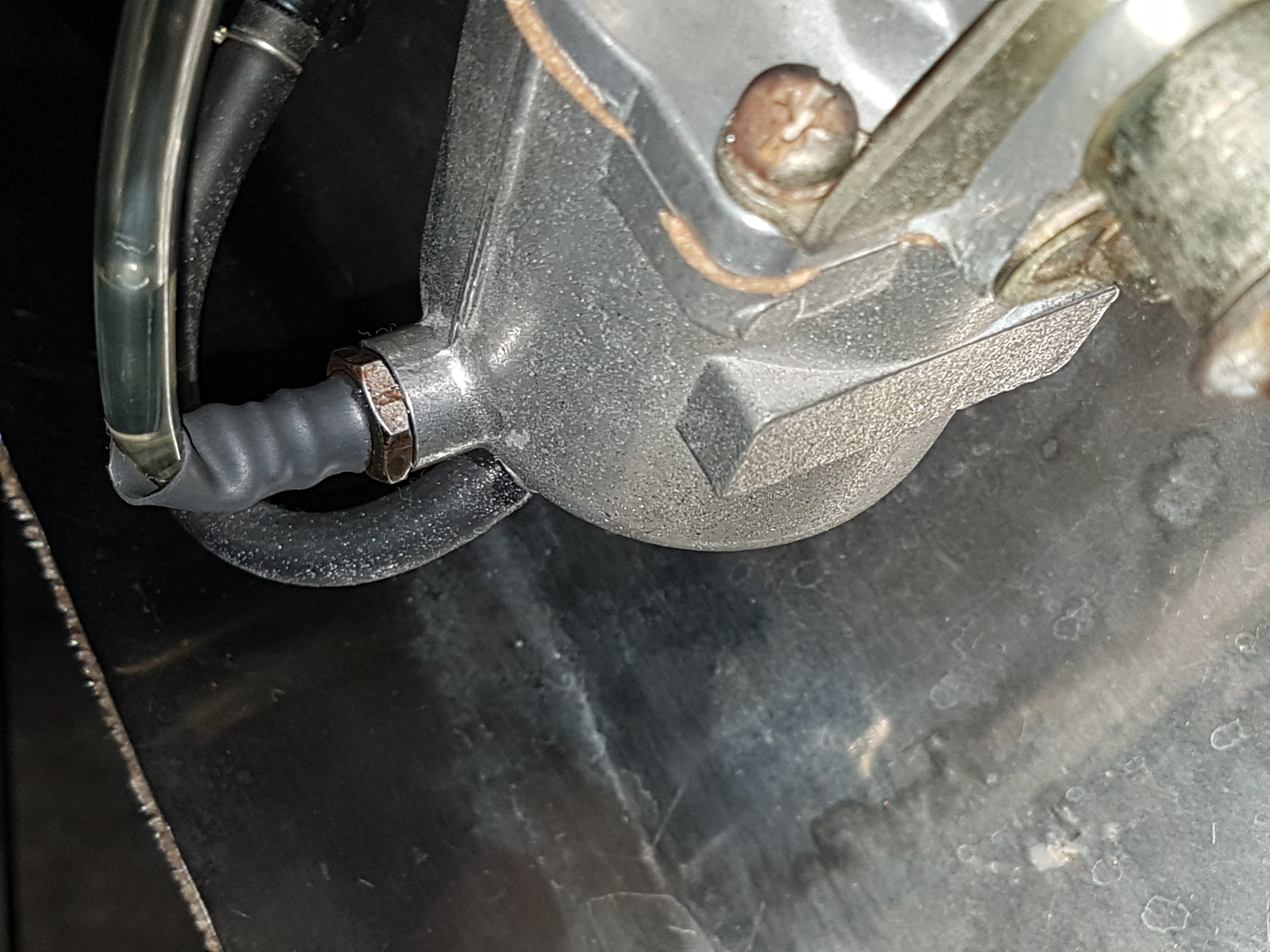

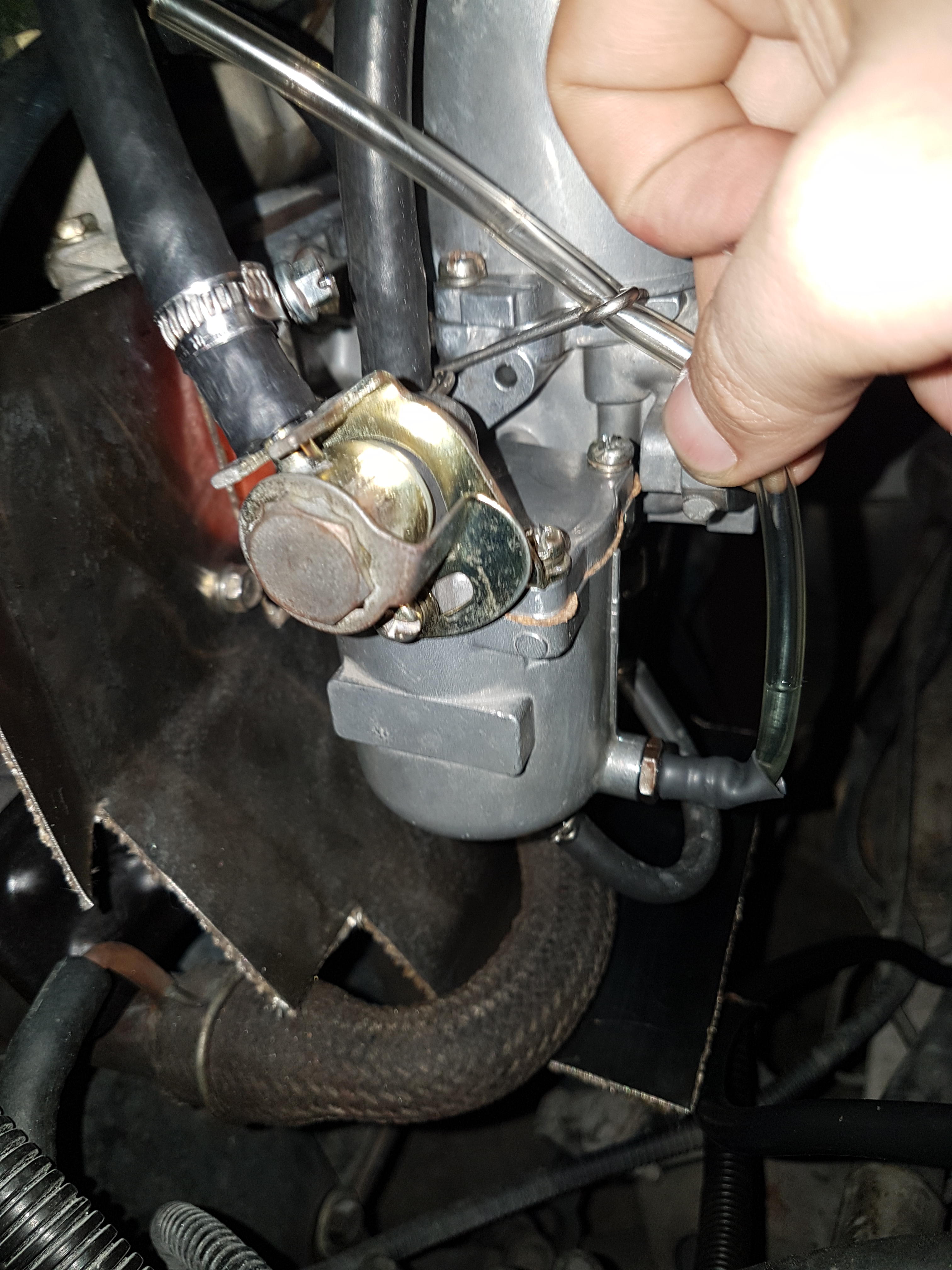

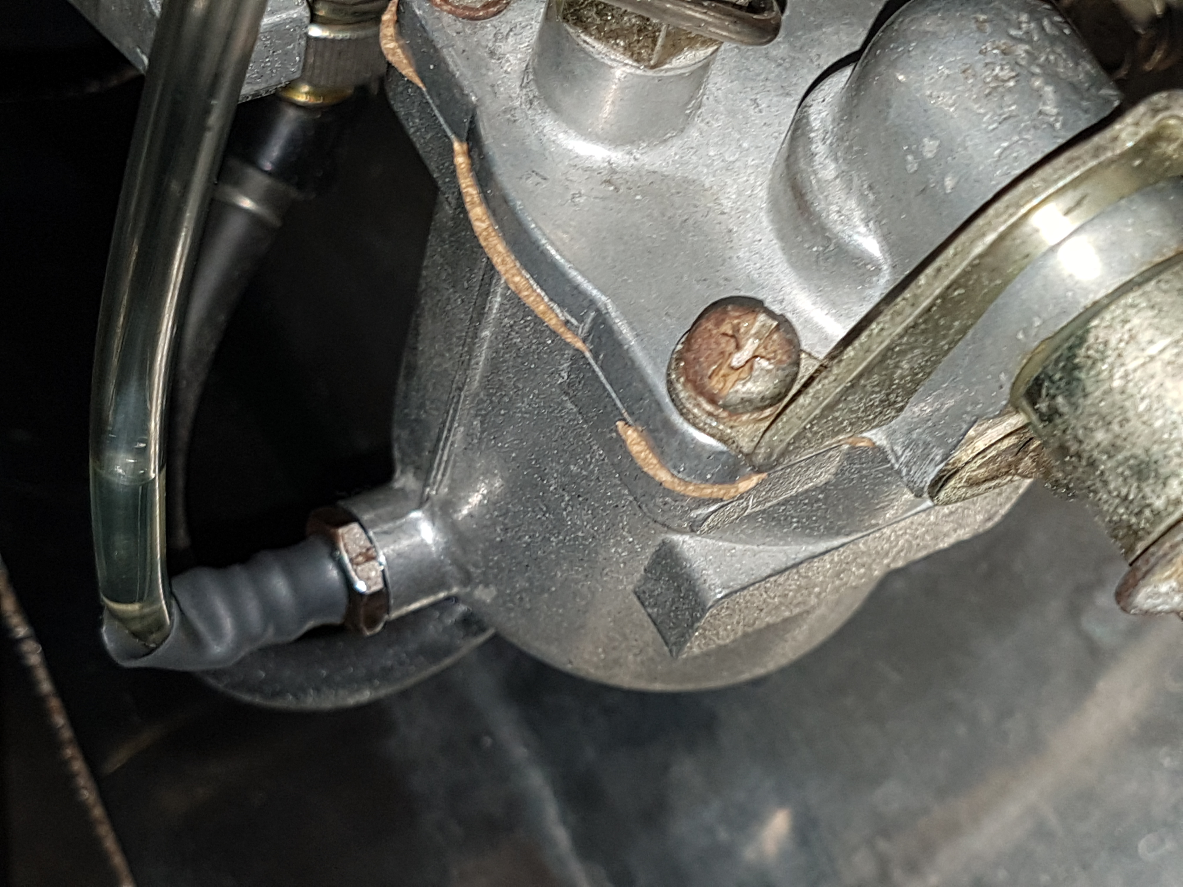

Are these fuel levels on the front and rear carb floats okay?
I know you are frustrated, but I'm not sure anyone is going to be able (or willing) to say your fuel levels are okay based on a picture of the tubing fluid level.
I personally think you should give up on the sight glass method you are using, and try something else. or at least check your levels with this method and see if you are way off base.
The problem is this diagram shows the level with the float sitting in the fuel, which would bring it further up than it would be when the lid is off.
This is why the method i used of 10 turns down of the nozzle checks this... as that would equal the 1cm down shown on the right side.  Use a flashlight to check the fluids position on top of the nozzle.
