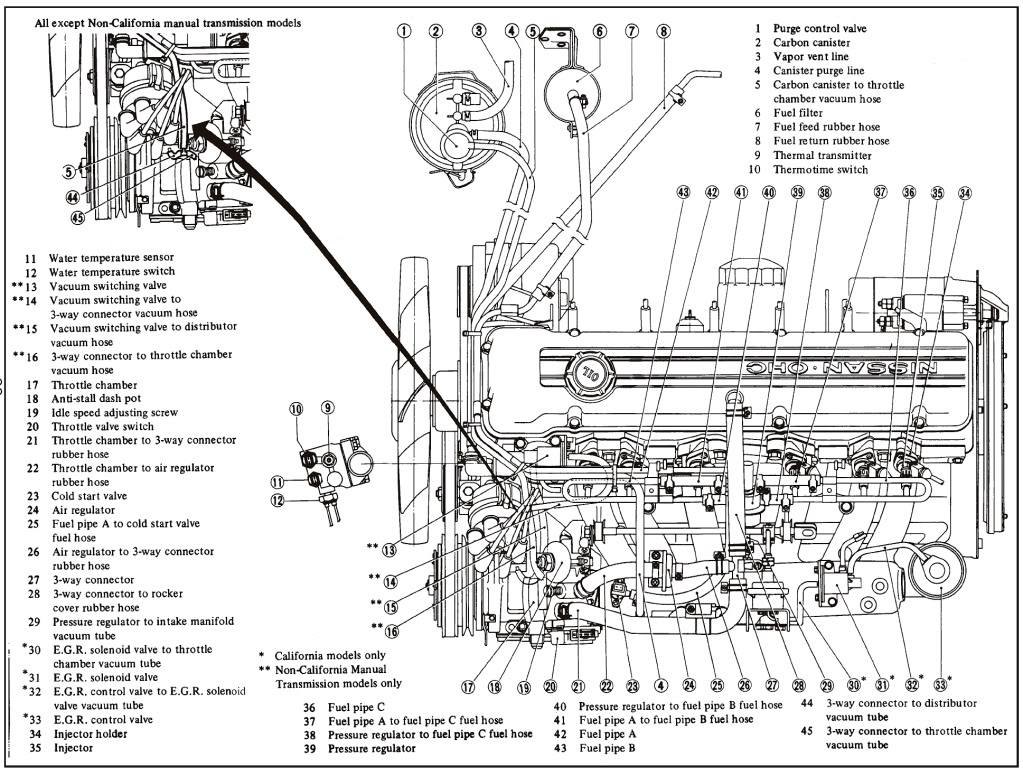

I need help with a 1977 280z. All the vacuum lines on the car where messed up and disconnected when I got it and I can't find a diagram anywhere. I guessed on a few. The car runs great for a minute then like garbage then great then garbage. It's really hard to start when she's cold and the rpm's are at 2000 until it warms up. It's not a CA car and has a 5 speed. Anyone know what the heck is going on

There should be a vacuum line diagram in there in the emissions section.
Truly the fastest method would be to chase down another 280Z and take pictures, draw diagrams. The FSM is ...obtuse.
I rather doubt your cold starting problems are related to vacuum lines. More likely your Auxiliary Air Valve isn't functioning properly, and/or your cold start injector isn't squirting. Suggest you SEARCH on AAV here and read up on theory of operation, cleaning/testing replacing.

Fast -- I agree, it's a GREAT manual --- better than most. But the FSM vacuum line diagrams are virtually IMPOSSIBLE to translate into real world "this hose goes from here to here..."
As often is the case with manuals, it makes PERFECT sense AFTER you get it all hooked up correctly...
Sadly I agree. The FSM as a whole is great, but the diagram for vacuum hose and fuel piping is not the easiest to read.
Here is a better copy of it that I found on the internet. I'm in the same boat, preparing to rework all the lines - so I just happened to be looking for it last night.
That's the same diagram in my FSM for 75. If you're talking about the vacuum lines for the HVAC controls that's a different story, they are usually brittle and somewhat difficult to get placed on the proper ports, and you must constantly refer to the FSM diagram and trace all the lines.

Many of the hoses came from the factory labeled with a letter on a small piece of tape. If you're lucky the piece of tape is still there. If you change a hose, move the label or put a new one on. The letters correspond to the diagram.
