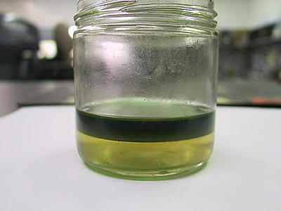

Ethanol is a major problem in any gas powered motor that doesn't get used often. The biggest problem I think is that E-15 type gas (up to 15% ethanol) was approved for all cars and trucks after a certain year manufacture date, but nobody ever said it would work in anything else. For the last 10 years or so its been wreaking havoc on small motors found in everything between a weed whacker and a motorcycle. As mentioned above, ethanol accumulates moisture so it sucks water into your gasoline mix. The fun part though is when you let it sit for even a few weeks the alcohol and other gas components separate creating 2 layers like this attached picture. Its gotten to the point where on my dirt bikes i have to completely drain the fuel after every trip or I will clog the carbs on all 5 bikes and these bikes were all manufactured between 2002-2006 so its not old junk. Luckily our friends at Sta-Bil have some new products that supposedly solve this problem. I have been using the marine formula in my generator and it seems to be doing the job. Sta-Bil products
