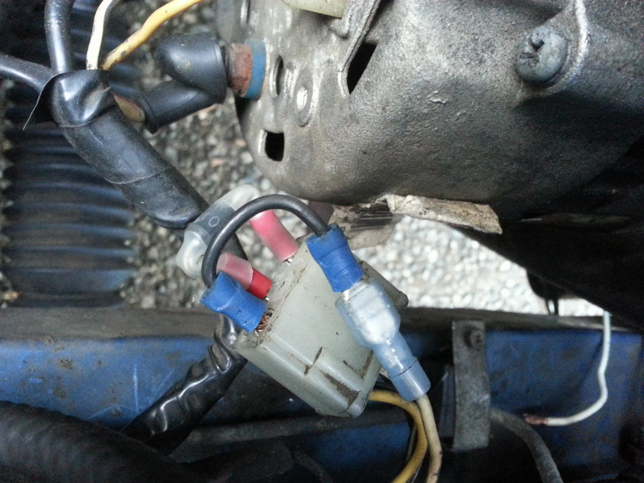

If the ammeter goes to the left of zero, you need a bigger alternator in my book. I've got a used 280zx alternator and it runs everything like a champ. "rewiring" to use an internally regulated alt is wizz easy, it's literally unplugging a connector and jumping the correct wires to each other in the chassis harness (early cars like ours like to have a diode in there to make sure the engine turns off when you take the key out, about a dollar at the local radioshark) . The 280zx alternator conversion kit plug does the same thing and looks sexy doing it, but it's not strictly required for a functional setup.
Edit: pictures of all my car's wiring modifications to run a 280zx alternator. The blue weatherproof connector on the white wire is just because it ripped out of the 6 pin harness connector and that was easier than trying to shove it back in.
