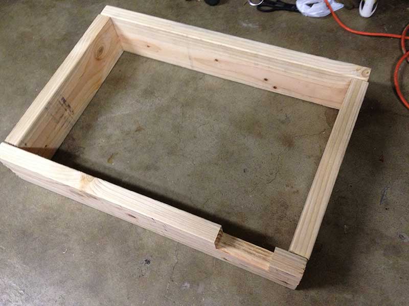

I started preparing wood engine cradle following this thread.
I will try to remove tranny with your methods.
