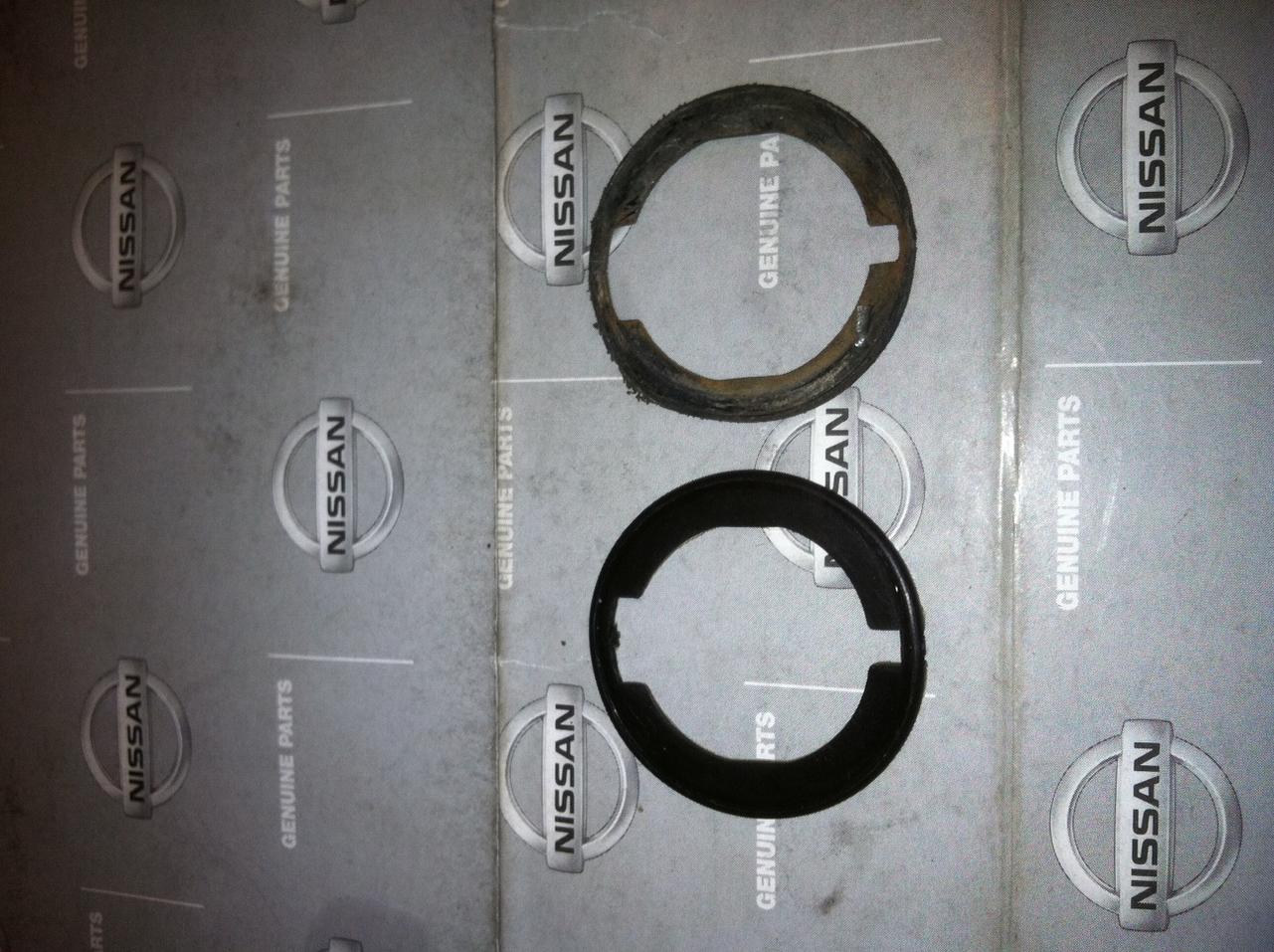

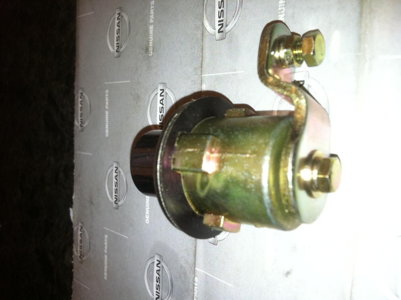

next is a request that I had and it is for the hatch lock seal.
replace that old hard worn out seal.

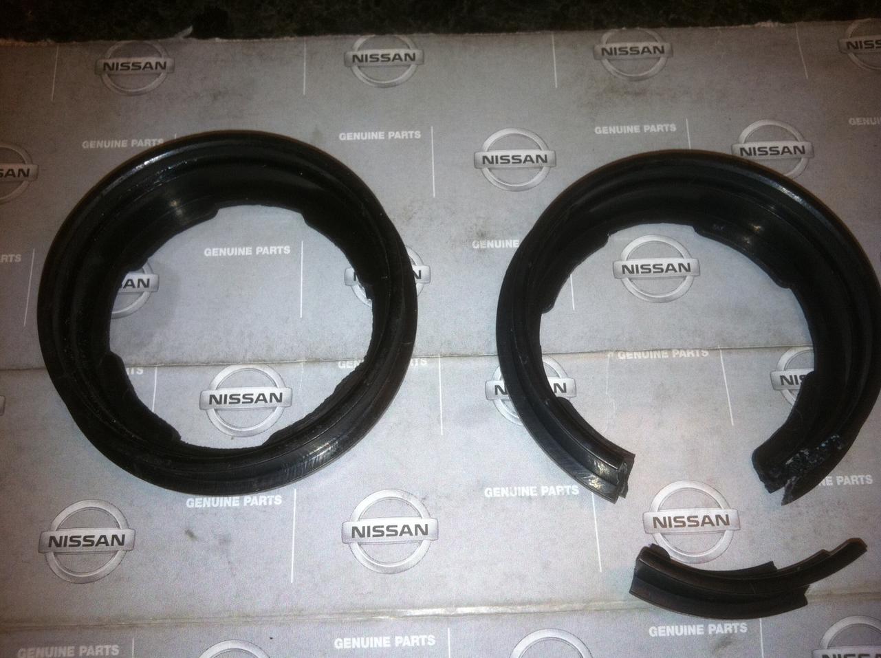

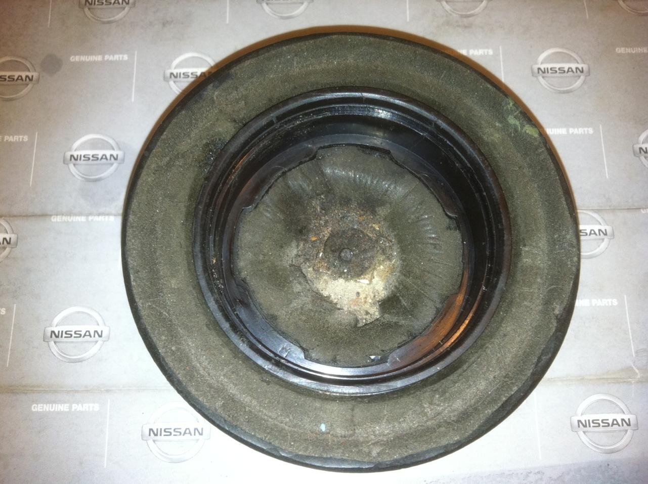

Replace your cracked horn pad plastic insert with this reproduction of the original.
A high performance urethane with very high compressive strength and tensile strength. Shore D Hardness;
85.
Very easy to cut out your old cracked or broken insert and epoxy glue the new reproduction of the original back in.

Clever. I almost threw mine out because of this. I will PM my list.
Steve,
That is a cool part. I worked up another repair for that but prefer your idea to mine.

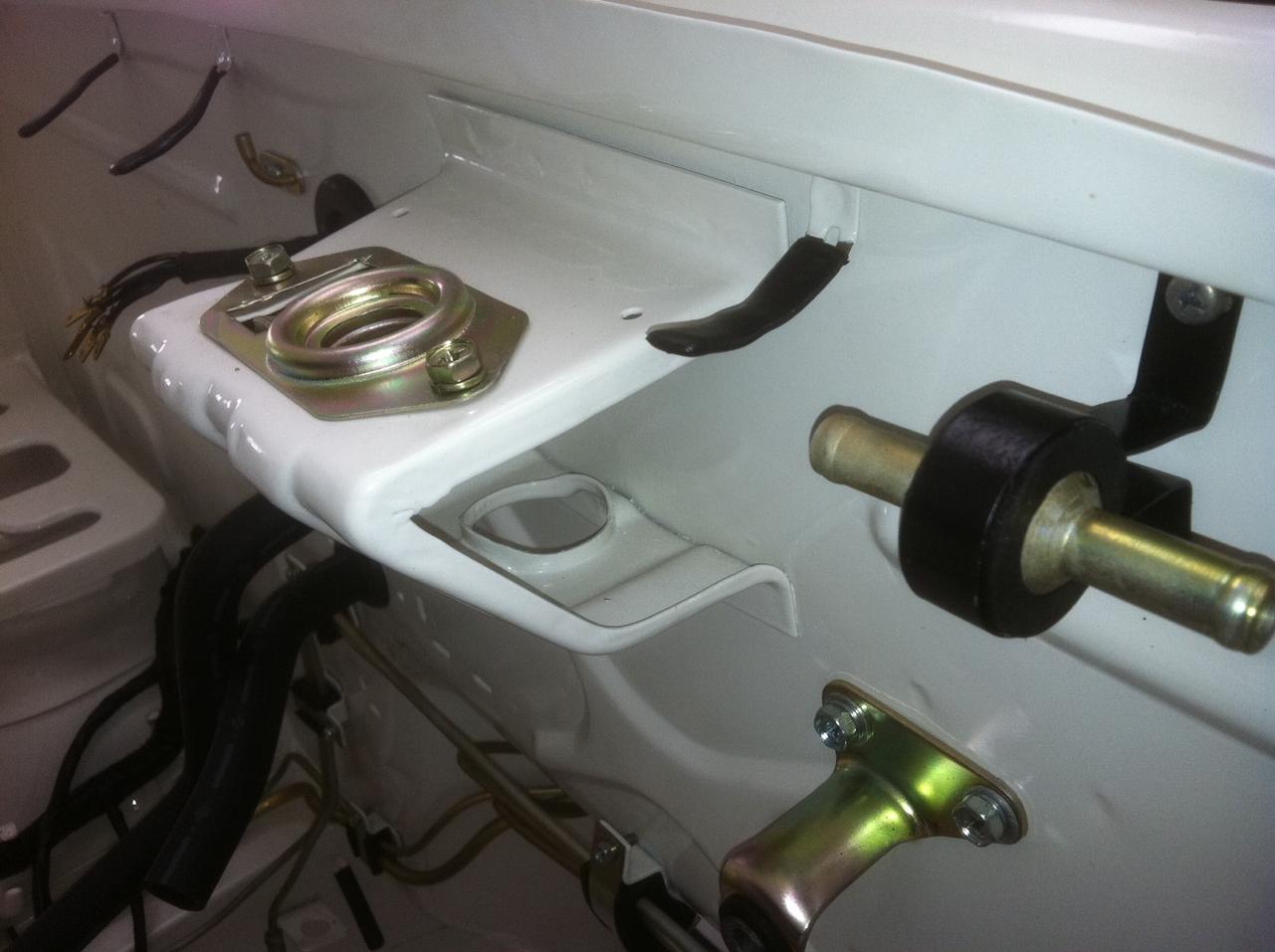

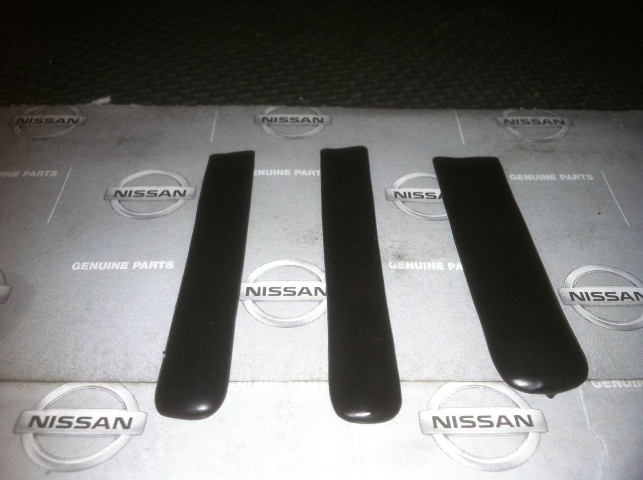

Another Item is the rubber coating on the wire harness bundle wraps that are predominately found in the engine bay. There is a total of 19 regular size and 2 of the wider type. These will be made to order only and could take up to 2 weeks, since these are very hard to reproduce.
At this time I am not making the main wiring harness type.
Steve,
So you are molding covers that go over the existing steel tabs. How tight are they? Do the tabs have to be really straight to get them back on. Is an adhesive required?
Charles
Charles, the tabs need to be fairly straight and are a tight fit, no glue required.
Steve
