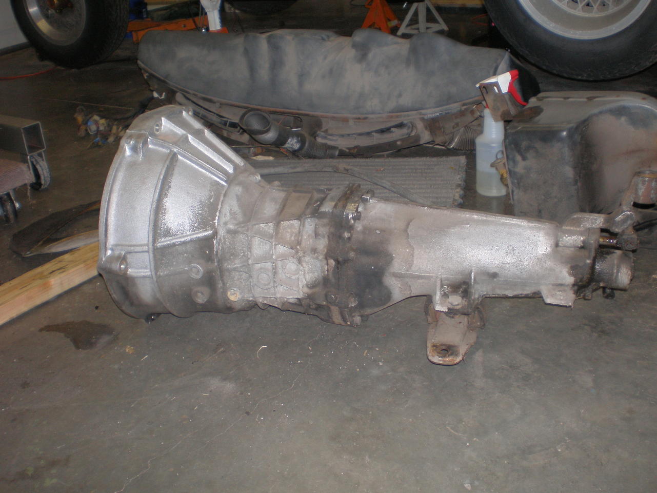

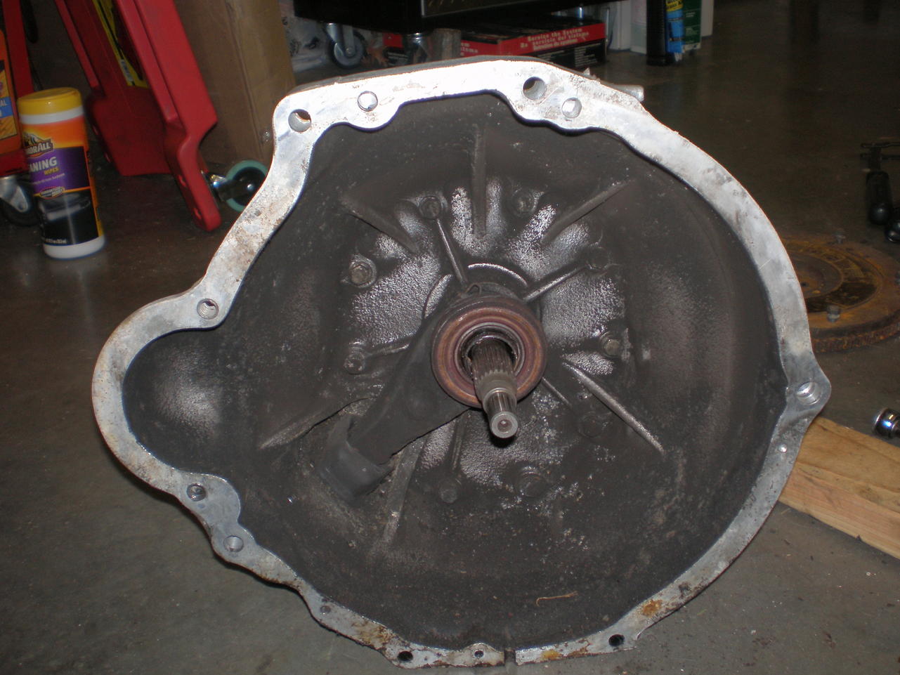

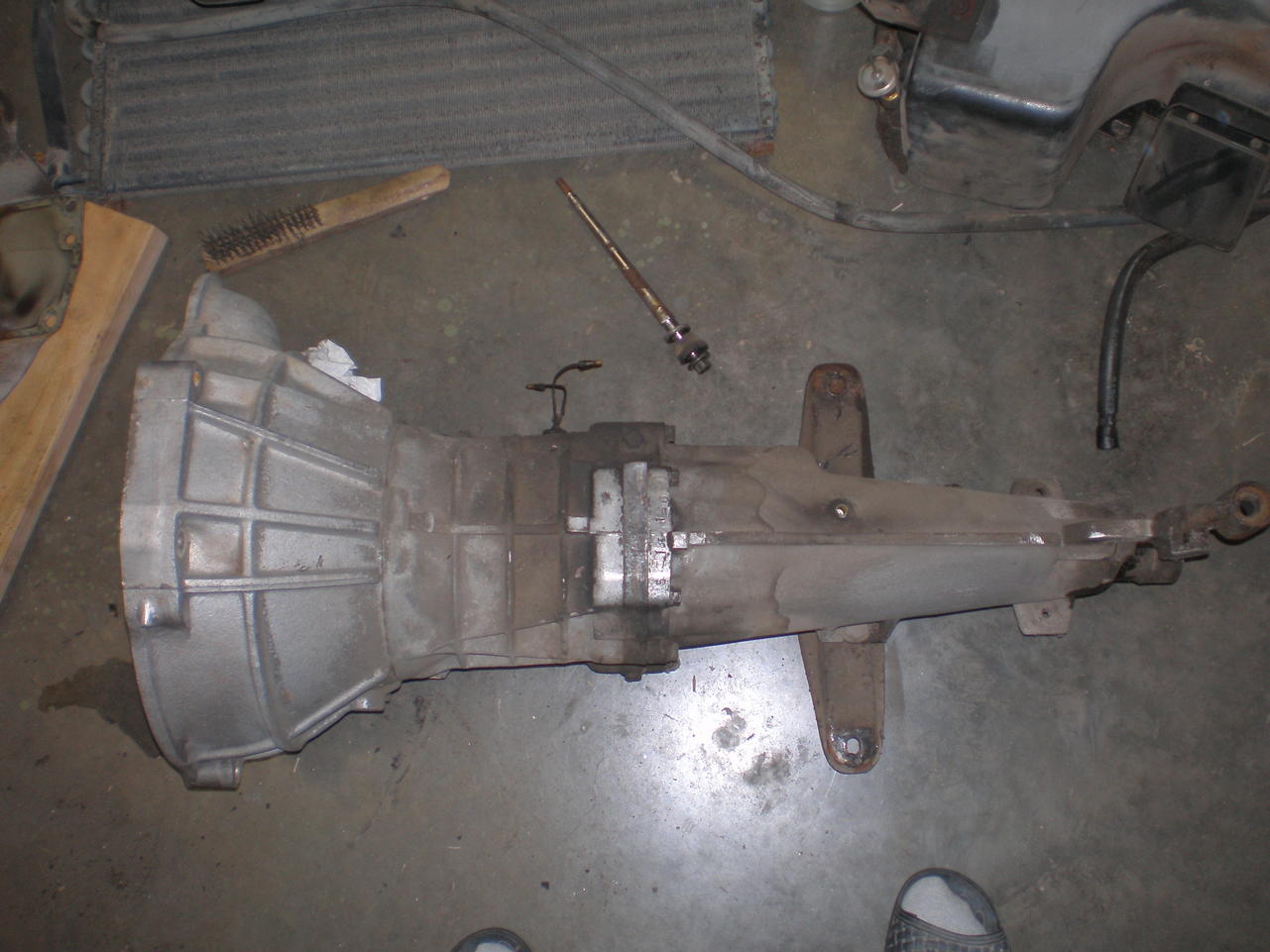

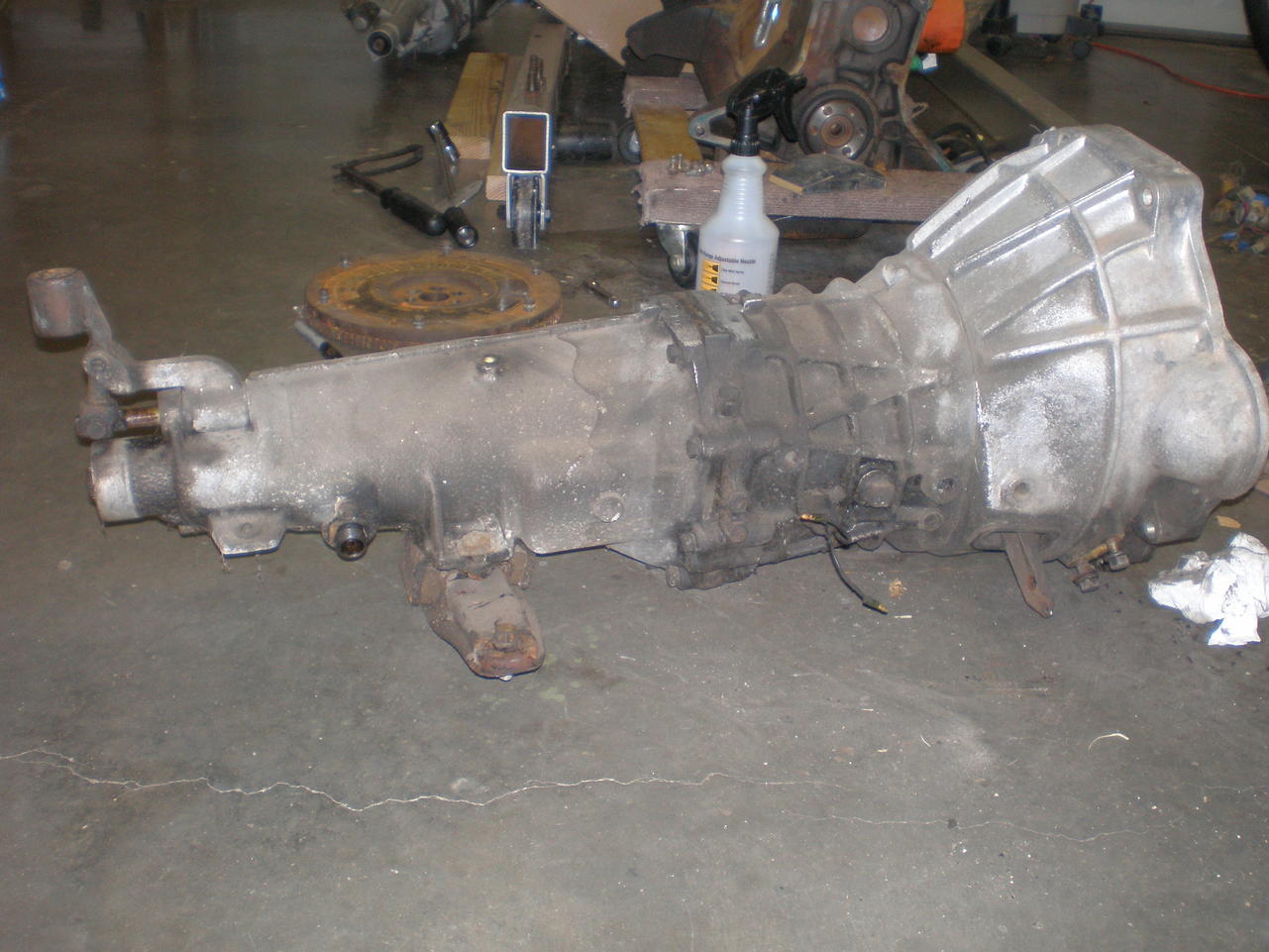

Hi, I would like to know what I have here 4 or 5 speed, or could this be a Datsun 2000 5 speed unit ?
You'll get better answers if you look for and post the part number that should be on the transmission.
Can't tell from the pics if it's a 4 or 5 spd. but it's not a roadster trans. Starter is on the wrong side.
Edited by sblake01
It could be a Roaster Tranny, if it has already been set up to use in a Z.
To put the Roadster 5spd. in a 240Z - you use the 240Z Bellhousing and change out the tail housing, main shaft an striking rod assy. Nissan Comp. used to sell a kit that contained all the necessary parts.
It is most likey a Type A 4 spd.
