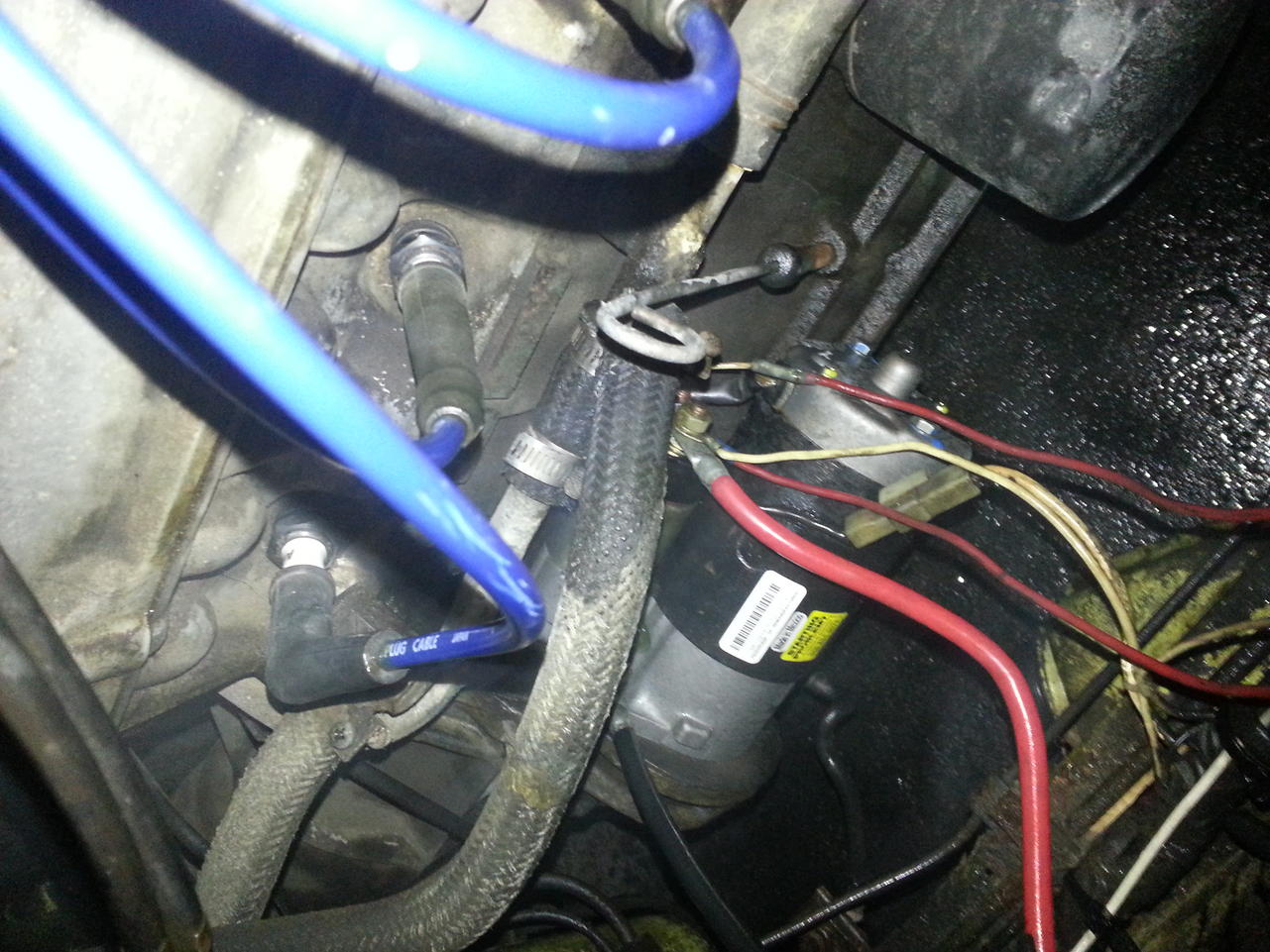

Forgive the photo, but on my way back to work from my lunch, I was horrified to see "smoke" coming from the engine as I was about to park.
I was somewhat relieved to see that it was only steam from the hot fluid in the cold air. There's a small cut in the hose (not easy to see in the pic, but its there), just left of the dipstick that was the culprit. Could you guys confirm that this is standard heater hose, and of what size? If I'm lucky, the hose will have enough slack I can cut it shorter and reattach it for now, put some new coolant in and maybe have her running to get home tonight.
I was able to shorten the hose and bypass the break, but on the drive home it reached 250 degrees so I'm guessing I'll be needing *even* more coolant.
Looks like the original braided heater hoses to me. I can't tell what exactly is leaking in your picture, is it the little short reducer piece thats about 3" long? I was able to get away with replacing that with a short piece of regular hose in a sort of inbetween size and some judicious hoseclamping, I forget the diameter. As far as the heater core hoses that penetrate the firewall, I suggest special ordering those from motorsport auto as they have some crazy pre-bends in them that'll just kink if you try and use regular bulk hose.

Im not sure I understand your second point, steve. Am I not supposed to burp the system if its the heater core hose? Its in the long pre bent heater hose that goes through the firewall. The break was in the fist inch of hose, so I was able to cut out the break and reattach it. Saving it for now. Youre correct. It is indeed the original braided hosing. Not the first bit thats been giving me trouble, either. Thats what 40 year old hoses get ya'...
