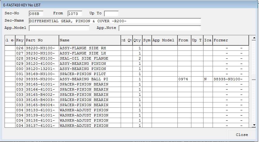

Chas, thank you for that tip. I tried backing off the nut and putting it to it's original position but when I do this the nut is almost loose at it's original position. It almost seems like the bearing has collapsed? I think I'am going to go ahead and replace the pinion bearings. Does anyone have nissan part numbers for the front and rear pinion bearings?

If the tension is very low, than the bearings a worn. You could try setting the tension to 30ft/lbs and see if its quiet. Give youself time to work out what to do. Changing the bearings is the easy part. If you dont have the height gauge to determine the shimes for the new bearings you have the adjust it using the crownwheel/pinion contact paterns. Reading and understanding the contact paterns is not easy and if you havent done it before it can take a lot of hit and miss to get it right.
