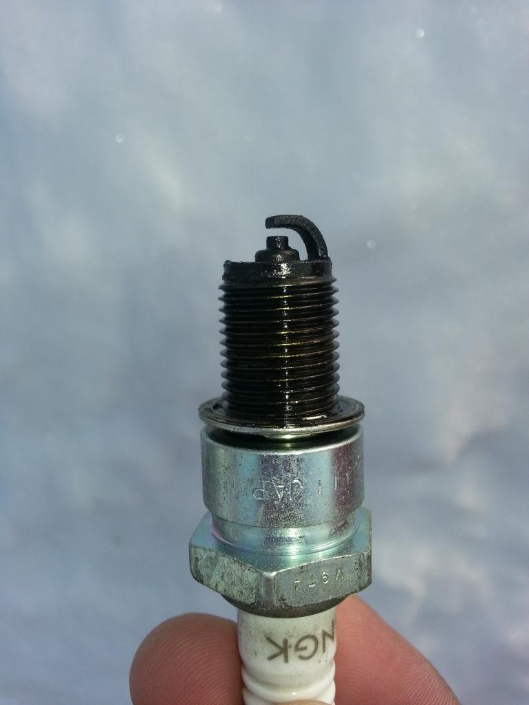

Oh, and for anyone wondering. I snapped a phone pic of the spark plug I pulled out, they all looked about like that. Funny, I've only put maybe a thousand miles since I last pulled them, and they were like new. But its been a damn cold winter and I've been running way too rich. I'll wrench on it some more in the morning and let you guys know what happens.
