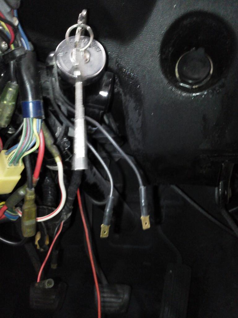

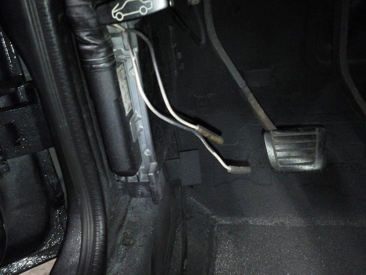

I also have two white wires down by the ECU that i am not sure about nothing to hook them up to. and on the ignition switch witch is a new on i have two wires black one with nothing to hook them to i looked in the FSM looks like they may have something to do with the buzzer and door switch .
There are times where a picture is worth a thousand words. This is one of those times. Are there stripes on the wires? Have you looked at the wiring diagram or EE or BE sections of FSM to see if you can find them? What connectors do the wires have?
I believe the wires by the ignition switch are for the key-in-the-ignition buzzer when you open your door.
The pictures did help a lot here. the two white wires are identified in the FSM wiring diagram as Control Unit Checking Unit. In other words, you don't connect them to anything. They are for testing.
