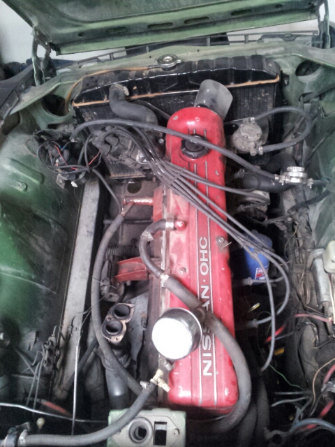

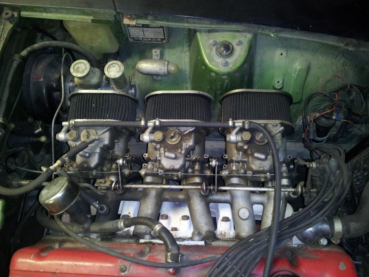

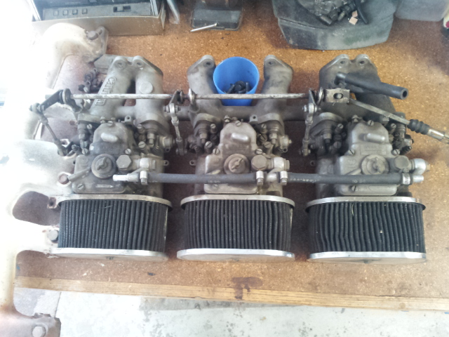

Finally starting the LS1 swap guys. I'm removing the triple webers and engine and will be getting rid of those to help fund the rest of the project. You have to appreciate how easy it is to drop one of these engines compared to a newer car. The car and engine I am starting with has about 90k on it, so I'm a little sad to be pulling it apart, but I plan to completely refinish the whole thing, so I'm dropping the whole drivetrain and getting it up an a rotisserie to start body work. Wish me luck.
Phase 1: Remove triple Webers and intake. DONE
Phase 2: Remove exhaust. DONE
Phase 3: Remove transmission
Phase 4: Remove engine (lift point suggestions, anyone?)
Phase 5: Remove diff
Have pics below so you guys can see the progress. BTW, if anyone wants this stuff... Ha!
