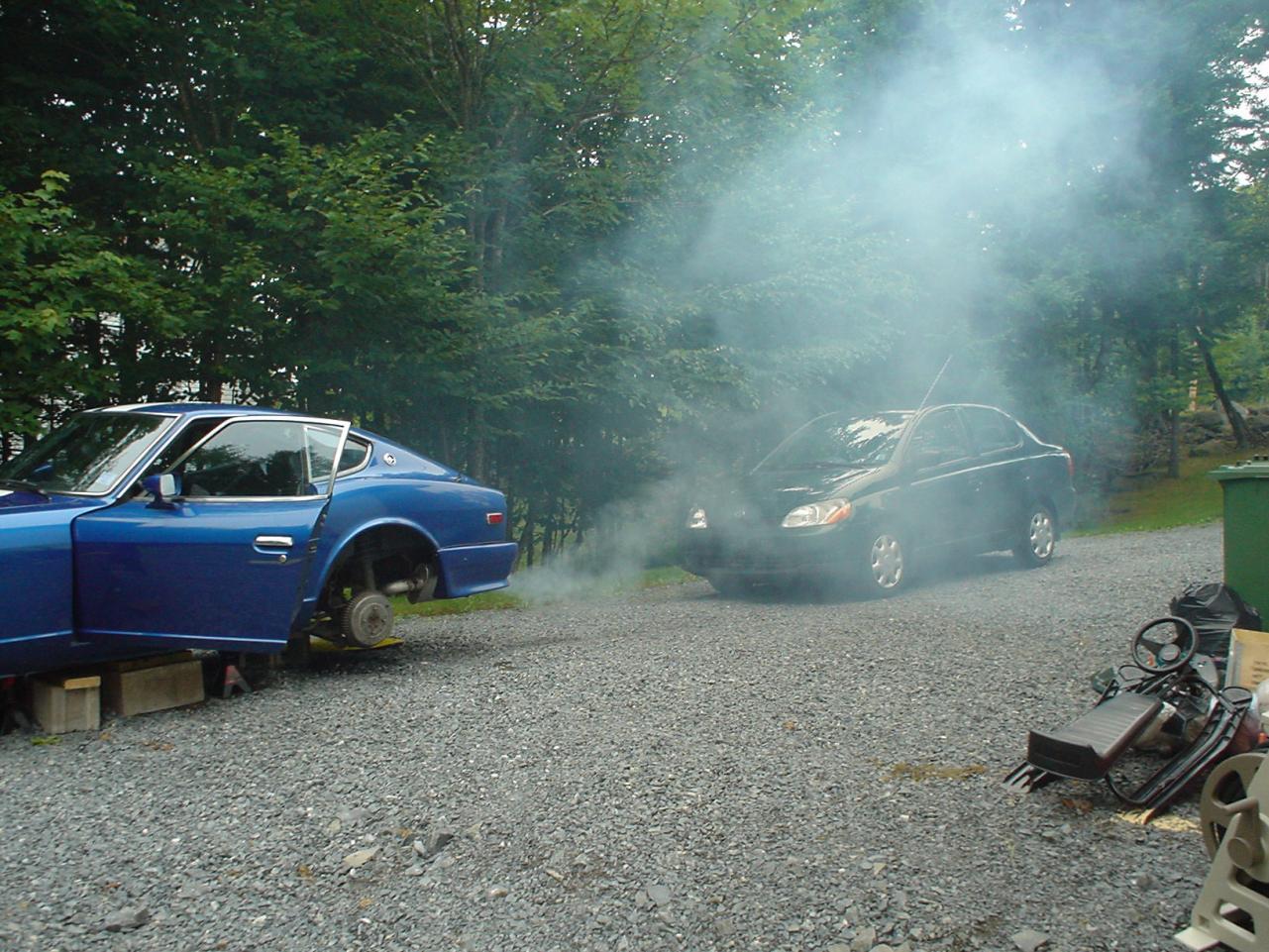

Here is a typical head gasket failure allowing coolant to enter the combustion chamber:

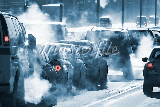

Here is another from a cracked head:

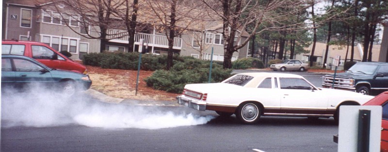

Here is a photo on a very cold day and you can see the white smoke from water condensing. This water is a byproduct of burning gas and is normally invisible:
