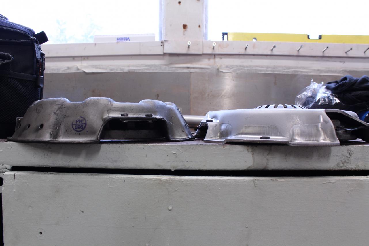

Left=old, right=new. Despite the fact that left one looks much bigger, there is only less than 2mm difference in "fingers". So i suppose i'll go with the bigger collar.
Don't be fooled .........measure the fingers where the throw out bearing contacts, not the housing. The fingers on the clutch on the right come out. Measure each fingers to the floor, not the housing. It's a PITA to pull it again so measure twice and cut once. I just installed an Exedy 240Z clutch this weekend.....I used the collar on the left. Works like a dream!
