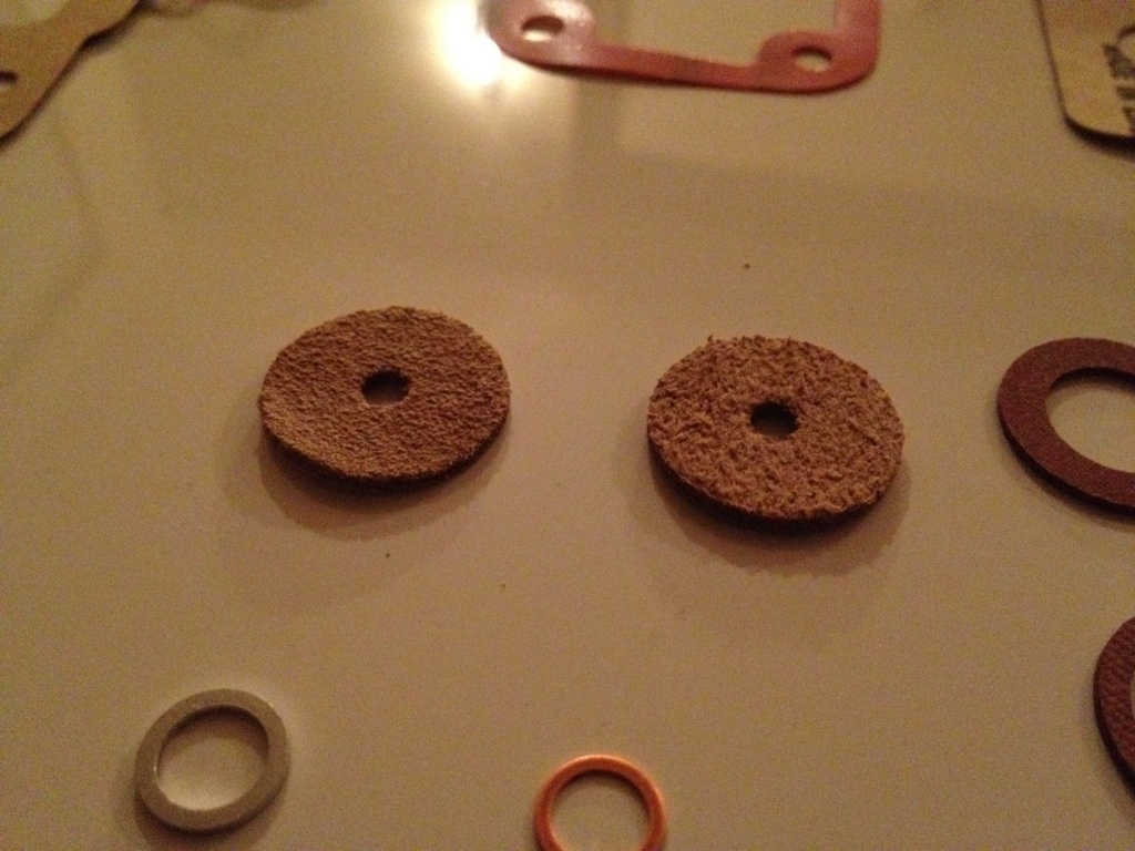

Hi guys, I got a set of webers of a parts car, and these need quite a bit of attention. I bought 3 rebuild kits from Pierce Manifolds. I looked through the kit to figure out where each component goes, but these two washer type gaskets got me a little confused. I took a picture and attached it. The only place I could think of was at the ends of the butterfly shaft to create a seal, but that's just a guess. Input is appreciated.
Hmmmm not sure now. I thought it was for early DCOE's throttle shafts but I can't find it in a diagram, Looks a bit like the seal on my Coleman Stove.

The kits have been 'generalized' so not all parts will be used. Pierce will confirm that for you if you give them a call...
