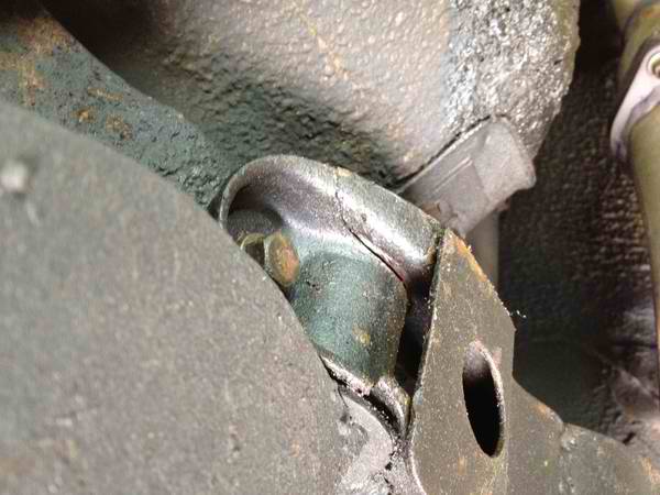

My Z ,aka ''FrankieZvettezetien'' busted a rear diff mount, A visit to a local machine shop is in order for a weld :post-25833-14150820359193_thumb.jpg....the old metal from Nippon is the one that busted ,the welded US iron is fine..........:disappoin

That should weld up just fine as long as they clean the area really well before starting. Put it this way, if welded right, it won't break at the weld again but might another spot.

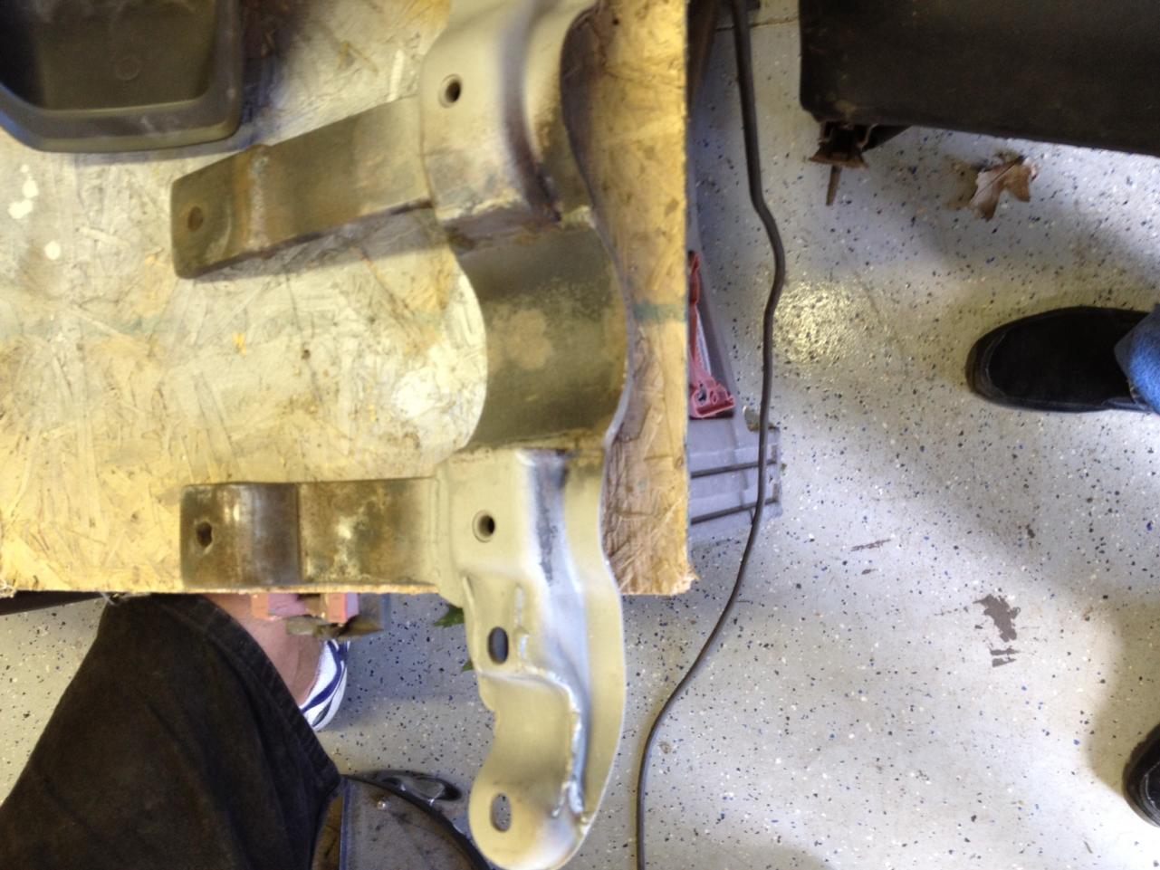

The weld is done, around 3 pm this afternoon went to my friends man cave ( lots of tools, lift + welding equipment) just to inspect the work needed to take apart the diff mount and the guys decided to tackle the fix. Let me tell you ,this two car nuts that helped me in this episode are 1st rate, took us five hrs . Well she now has beauty scars marks, ''FrankieZvettezetein'' is back on the road in record time...........;)

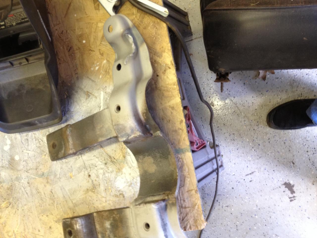

post-25833-14150820504279_thumb.jpg this was the section that busted,,,,,,now all welded up ;),,,,,,,,,,,,,,first pic is me as a reference of I felt after this episode LOL
