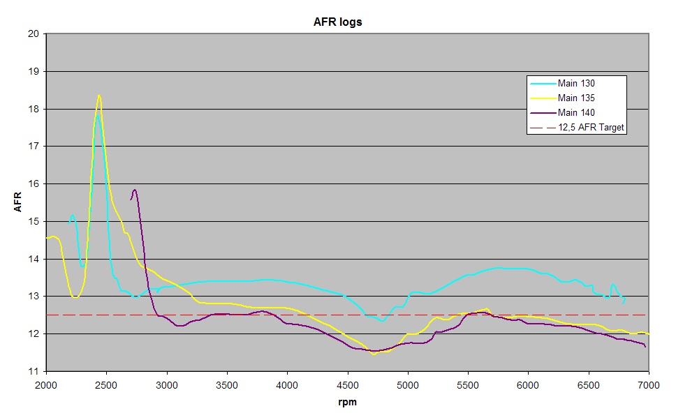

presently
40DCOE151
125 main
170 corrector
F11 emulsion
30mm Choke
4,000 RPM 11.5 Air/Fuel
6,000 RPM 10.5 Air/Fuel
240z L24 270 cam
I am thinking that a switch to 115 may lean it towards 12.5 at 4k and at the same time tip the the high end back at 6k. Any suggestions?

Rich at high rpm could very be your chokes being undersized also but 11.5:1 at 4000 is too rich, I would go down to 115 since you have a lot a fuel to restrict to get back to proper AFR at WOT.
here is a graph with my previous setup with F54/N42, Schneider stg 2 cam & 40DCOE-18. You can see the difference in AFR between mains.
Edited by Lazeum
Thanks Lazeum. That is the data I wanted to see. 140 to 130 raised your AFR by 1 point. I should do the same and try a 115.

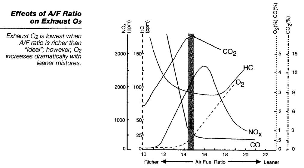

Catalysis reaction only occurs at 14.7:1 AFR, that's why car with catalytic converter have always an O2 sensor; it is to allow the ECU to run in close loop mode to regular AFR to be as close as possible to 14.7 ratio.
Running leaner than 14.7 on our car is creating more NOx & CO2 but less HC & CO but to a small step which makes it not so interesting. See the graph below.
[ATTACH=CONFIG]56363[/ATTACH]
Let's compare 12.5 and 17 AFR on the chart you posted:
  • CO is way lower
  • HC is slightly lower
  • NOx is about even
  • CO2 is about even
Comparing running 14.5 AFR with 17AFR:
  • CO is slightly lower
  • NOx is slightly higher
  • CO2 is slightly lower
Plus, you get an additional benefit of higher mpg.
You're right about requiring more spark timing with leaner mixtures and lighter loads, but that is why I recommended to run as lean as possible without misfire (or losing power). Certain combinations will be able to attain leaner mixtures than others, depending on mixture distribution, spark timing, combustion chamber design, etc.
