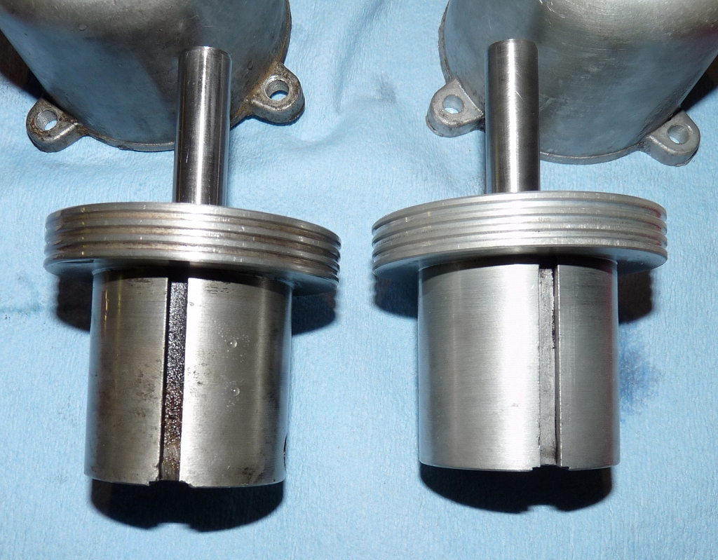

240260280z Posted October 16, 2013 Author Share #26 Posted October 16, 2013 (edited) Comparison with original and dipped/soaked for 2 hours and just dried. The orange/copper colour lessens through hand rubbing with a cloth and a brilliant yellow shine appears . Sad to see one of the 6 F11 e-tubes is an F2 ... I bet the PO had fun tuning. I also noticed the lemon juice did not remove crust in the grooves of the accelerator pump piston. I think ultrasonic cleaning in a solvent and a mild acid like the lemon juice would be best form of cleaning. Edited July 16, 2014 by Blue Link to comment Share on other sites More sharing options...

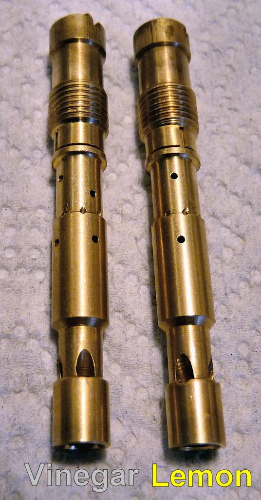

Bonzi Lon Posted October 17, 2013 Share #29 Posted October 17, 2013 Household vinegar works great on copper, brass and bronze, not so well with aluminum, it is the difference from citric acid in the lemon juice & acetic acid in the vinegar. Gives any copper based object a new look if you don't want an aged patina. Bonzi Lon Link to comment Share on other sites More sharing options...
240260280z Posted October 17, 2013 Author Share #30 Posted October 17, 2013 Thanks Bonzi! I just tried both for 30min (soak then rub with paper towel). The vinegar cleans faster and better (look at the carbon on the top holder). The lemon seems to be less yellow in tint but shinier. Have a look: Link to comment Share on other sites More sharing options...

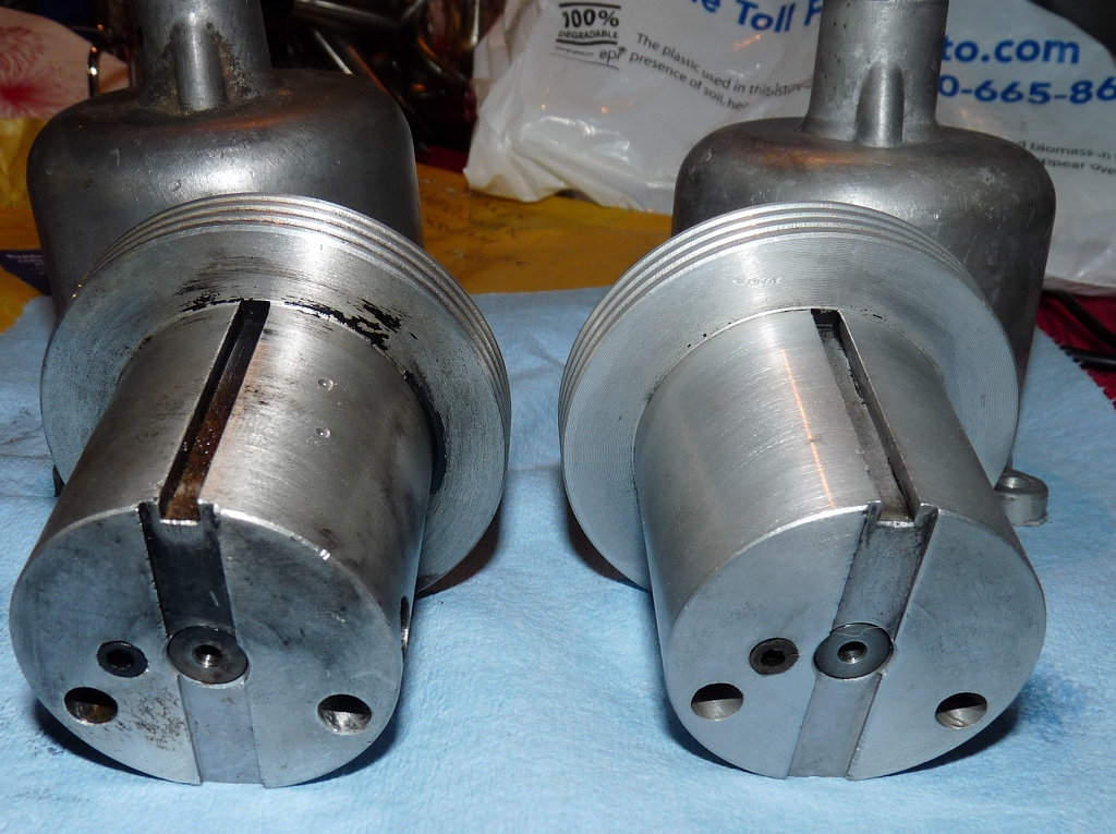

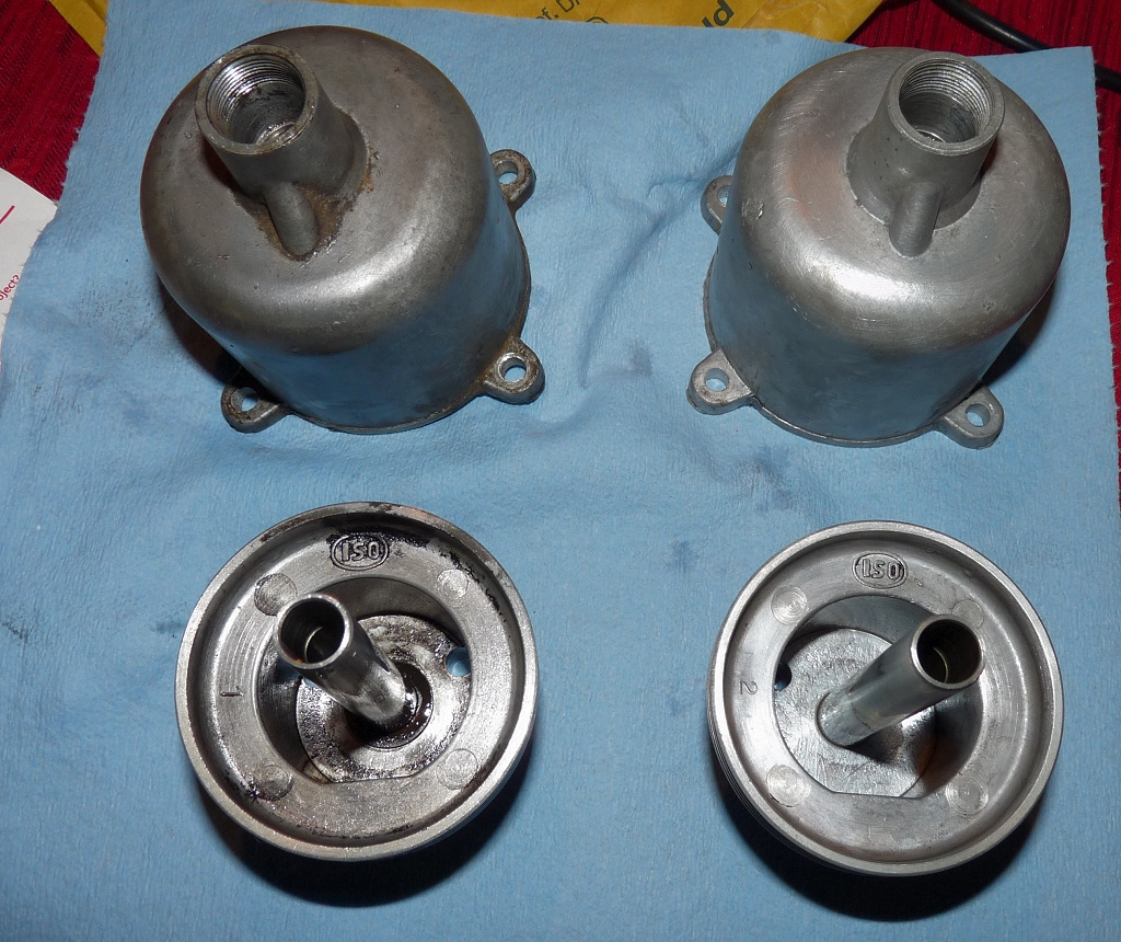

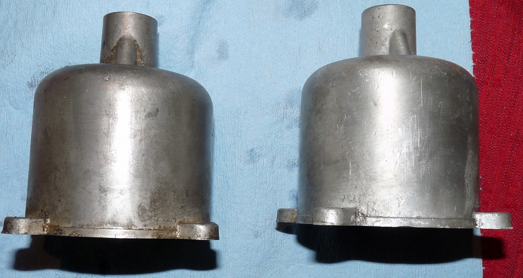

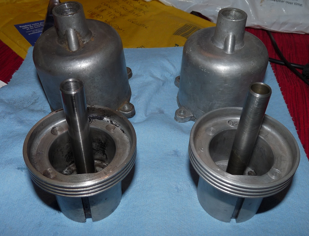

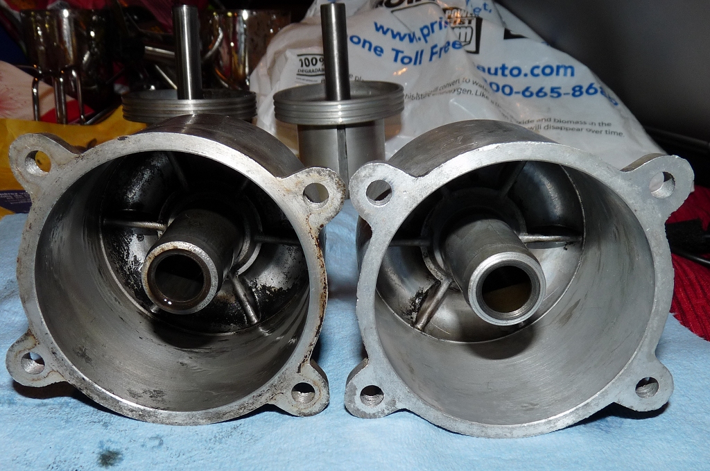

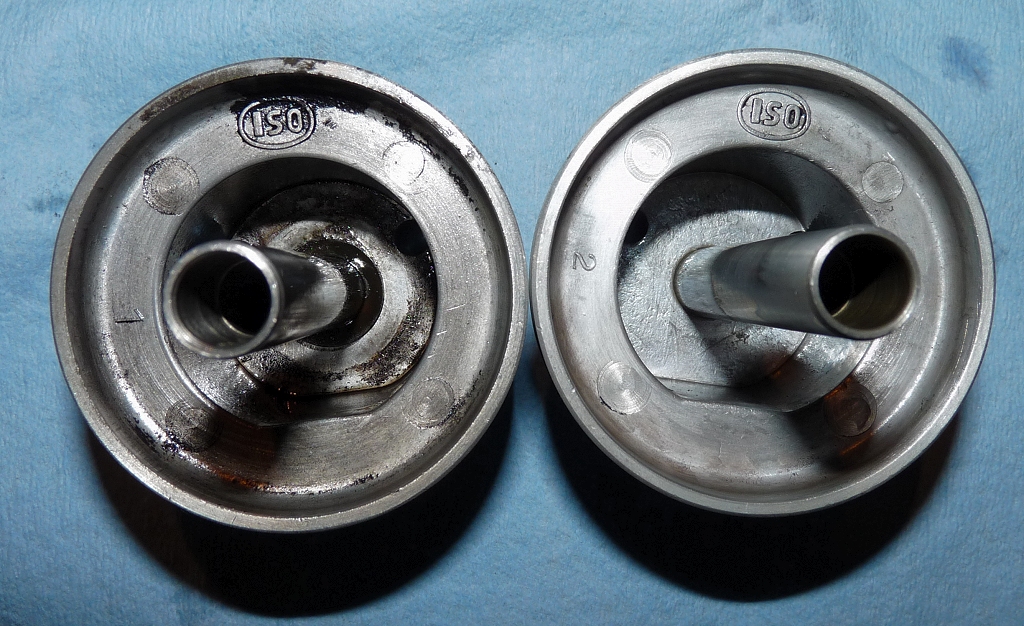

240260280z Posted July 16, 2014 Author Share #31 Posted July 16, 2014 OK I gave it another go: Enamel pot on the Barbie with lemon juice and some vinegar. Rolling boil for ~ 20min is the trick. It degreased the carbs and the carbon flakes off. Here are some pictures: Link to comment Share on other sites More sharing options...
