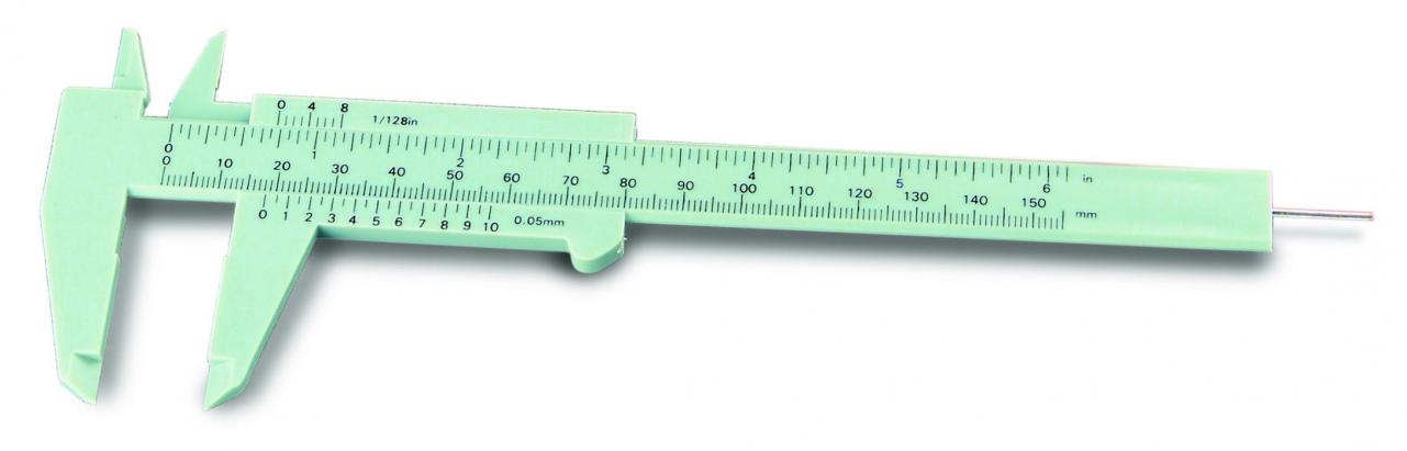

For measuring fuel depth, the wire end of a $1 plastic vernier caliper works great. I can easily see it touch or not touch the fuel surface as it deforms the well meniscus and reflects light differently. My accuracy is less than 0.5mm and the plastic end of the tool fits squarely across the top of the well
If I had to do more of these, I would just buy 3 calipers and lock at 25.5mm, 25.0mm and 24.5mm for go/no-go testing.

For this thread's completion: I set the three carbs to 24.5mm 24.5mm and 25.0mm. It eliminated the transition bog!!!
