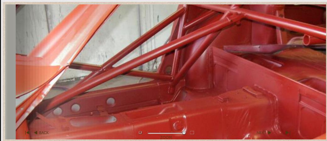

A beautiful build! I want to steal the main hoop mounting idea for my autocross Z. I hope you don't mind. That's the first one I've seen done that way.

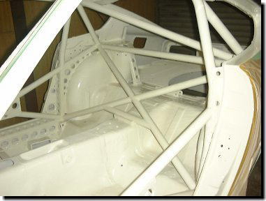

Here is a Japanese variant. It has a lot of strong gusset's but I think the main loop in Greg's resto is the stronger design for driver protection.
The Japanese design puts the cross-members so far behind the driver (at the rear wheel well) that there is very little side-to-side protection at the seat compared to Greg's.

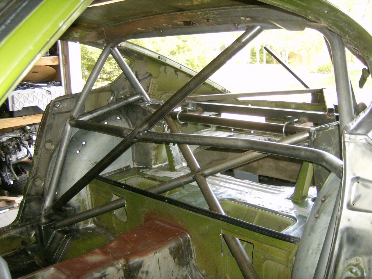

I've done something similar on another car. A simple rollbar for the orange one is planned. Come to think of it, Jon Mortensen buit one like Mr. Ira's but then added a box underneath. Greg's build is so clean and well finished. I bet Pete Brock would approve of it.

Thanks for the good words. I like to make every bar count in my rollcages. We don't need "birdcage" Z cars. I use 1.5" tube in most of mine because it really does take up less room, even though it seems small. A few of the most important things I consider. Main hoop scallop and plate into rocker panel. Horizontal bar behind driver with no bends. Nascar bars at driver door with no S bends. Forward down hoop tie in to footwell/firewall junction. This is also in the location of the frame rail. Knee bar not placed too low. These cages have proven to be very stiff.
A lot of these little things are hard to do when you actually get down to it and if you've done one you know what I mean. Feel free to call me with any questions.
Steve, that box at your main roll hoop bottom is pretty nice looking. I bet that took some time...
