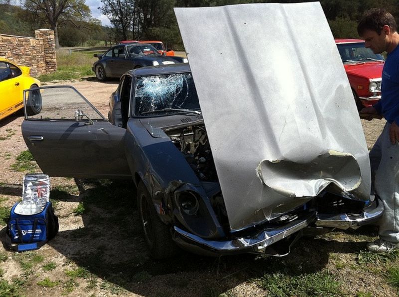

that picture physically makes me ill. Is there a story behind this poor injured Z?
