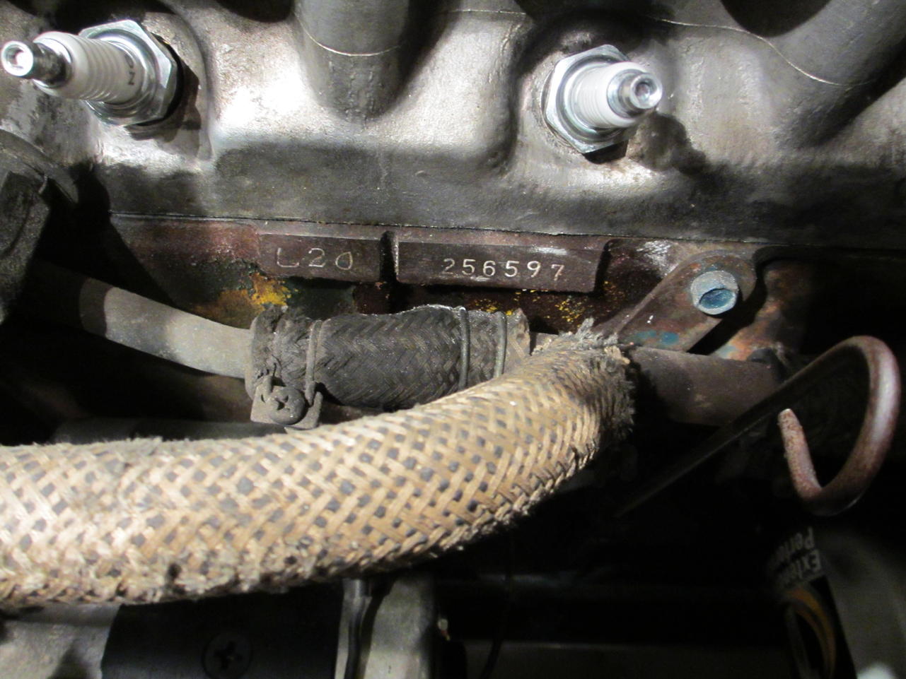

May 10, 201411 yr comment_447575 What is so confusing to me Alan is the pictures of the L20A and the L20 in my factory service manual. The L20A is shown as having one down draft style carburetor instead of the two side-draft Hatachi carbs.The message I'm getting is either the Factory Service Manual is incorrect with the photos or my FairladyZ is a factory fluke. I don't find an "A" or "B" suffix stamped anywhere relating to the engine type or number, just L20 256597 stamped on the engine number pads on the engine block.No wonder there is much confusion about these since the factory and dealer paperwork is long gone ... at least the Nissan historian couldn't come up with anything other than "your car is an S30 model FairladyZ built in 1971."As I've opined many times, the only thing I really know about these cars is this one. I know the original owner in USA in the early 1970s, how he got the car, who bought it next, and I got it after that. I'm really only the second owner of it in the US as the original guy sold it via a dealer who didn't transfer the title until I bought it ... for WAY TOO MUCH money at the time ... but glad I did.So, this FairladyZ-L: .... came with the L20 dual carb engine (no "A", no "B" suffix engine) coupled to the 5-speed tranny ending in the R180 pumpkin, which it still has ... unmodified. And as far as we can tell, at 79000 miles the engine has never been cracked open. No valve work, no nothing. Trans is the original one never reworked (it does have a tick tick indicating a weak bearing, but nothing to tear into yet), and the rear end is untouched.I've repainted it to Nissan 901 with a color match to the untouched inner body hatch panels still in original paint (we think).These cars can be as much a mystery as anything I guess.Upon that I think we can agree.Yes, you're right. I don't think I put that very well did I? The L20 six got the 'A' suffix well before the L20 four arrived with the 'B' suffix. The story that was related to me when I looked into this was that it was a case of killing more than one bird with one stone. Yes, they needed to differentiate between the early style L20 six and the updated L20 six, so they started to use an 'A' suffix on the updated design. A good illustration of this was in the factory parts manual for the GC10 Skyline: This had sections for both the 'early' / 'old' type L20 six and the 'new' L20'A', as the earliest GC10s were equipped with the 'old' type L20 sixes, and then they switched to the 'new' L20'A'. It must have been quite confusing at the time to have the same model of car fitted with two versions of what was essentially the 'same' engine.Those first 'new' L20'A's had the 'A' stamped into the pad on the block that carried the engine number. No doubt this was an effort to make sure there was no confusion, but it's possible to see Nissan's period advertising and other technical descriptions not differentiating between the two types. I don't know whether that was deliberate or not? And just a year or so down the line ( late 1969 ) Nissan were churning out what were clearly 'new' type L20As without the 'A' being stamped on the block as part of the engine number. Quite confusing. Again, the story I was told was that the 4-cylinder L20 was 'on the drawing board' - or at least being mooted - during the 1968/9 period when the L20 six was updated, hence the 'A' and 'B'. Even if they were not ready to make it yet, we can imagine that they could see a 4-cylinder L-gata engine of two litre capacity being necessary somewhere in the near future. If that wasn't part of a long-term plan then it would have to be a big coincidence, no? One thing is for sure: Those 'A' and 'B' suffixes did the job of differentiating between the six and the four, and the 'old' and 'new' sixes. But anyway, Kerrigan's Fairlady Z-L was fitted with the 'new' type L20 six, which the factory called an 'L20A' at the time. Edited May 10, 201411 yr by Kerrigan spelling error Link to comment https://www.classiczcars.com/forums/topic/42076-1971-fairlady-z-one-owner-on-cl/?&page=3#findComment-447575 Share on other sites More sharing options...

June 16, 201411 yr comment_449931 Thought the reply was a little parental in tone, but thought I'd ask anyway ... as you seem knowledgeable ... what are the physical differences between an L20 and an L20A engine, cause I didn't find any info explaining that on the Internet? The one picture I have seen had the "L20" stamped on the first stamp block as shown below, but the engine number has an "A" stamped before the numbers on the second stamp block. Edited June 16, 201411 yr by Kerrigan clearification Link to comment https://www.classiczcars.com/forums/topic/42076-1971-fairlady-z-one-owner-on-cl/?&page=3#findComment-449931 Share on other sites More sharing options...
June 23, 201410 yr comment_450311 Guess I've been wrong about the engine in these cars. Only had an L20A, not an L20. Apparently they never had a L20.Amazing really, I learn something new to me about these FairladyZs every week.Our 1971 FairladyZ-L has the original L20 engine, not an "L20A" .... Edited June 23, 201410 yr by Kerrigan Link to comment https://www.classiczcars.com/forums/topic/42076-1971-fairlady-z-one-owner-on-cl/?&page=3#findComment-450311 Share on other sites More sharing options...
