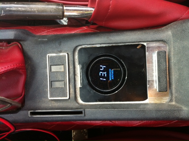

Carbs are synched within a 'gnat's breath' and were effectively pretty well jetted for Sonoma, CA (Original Customs) restoration shop that I use. I trailered back to Reno yesterday and got her off and fired her up. Still runs nicely, but the A:F ratio numbers moved to the rich side in a dramatic manner. 9:1 range for idle and just on the rich side for acceleration. I didn't dare do WOT testing as I live within a few short blocks of Damonte Ranch High School and I would imagine there is a cruiser or two waiting for the boys to display their testosterone...
All my jets are in a box in a Sacramento storage garage so it will have to run a bit rich for now. I am looking around for the stock choke mechanicals that I can cable up to the Webers with for now. I managed to find a lever and mount with all the electricals for the light on ebay but when I got it I realize it is meant for the right side of the console and mine, a '73 is on the left. Anyone want to trade?
