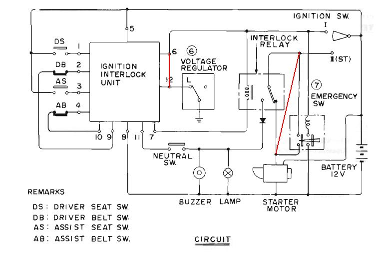

My first suggestion is to make sure you have properly bypassed the seatbelt interlock relay. Search on here. I know I've done some posts on that. It can be as simple as putting in jumpers to fool the seatbelt circuit into thinking the seatbelts are buckled. If you are more adventurous, I have attached a drawing from the FSM showing what wires need to be jumpered out to bypass the interlock relays. However, you'll need to match this up to the full wiring diagram to know what wires to jumper.
