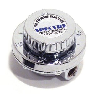

We have been using this one. It is a cheapy for sure but has worked well on our stock engine. I suspect for higher horsepower it might not flow enough fuel.
As far as filters go, a filter before the pump is necessary for rotary type pumps such as the Holley. Diaphram pumps are more tolerant of dirt.
