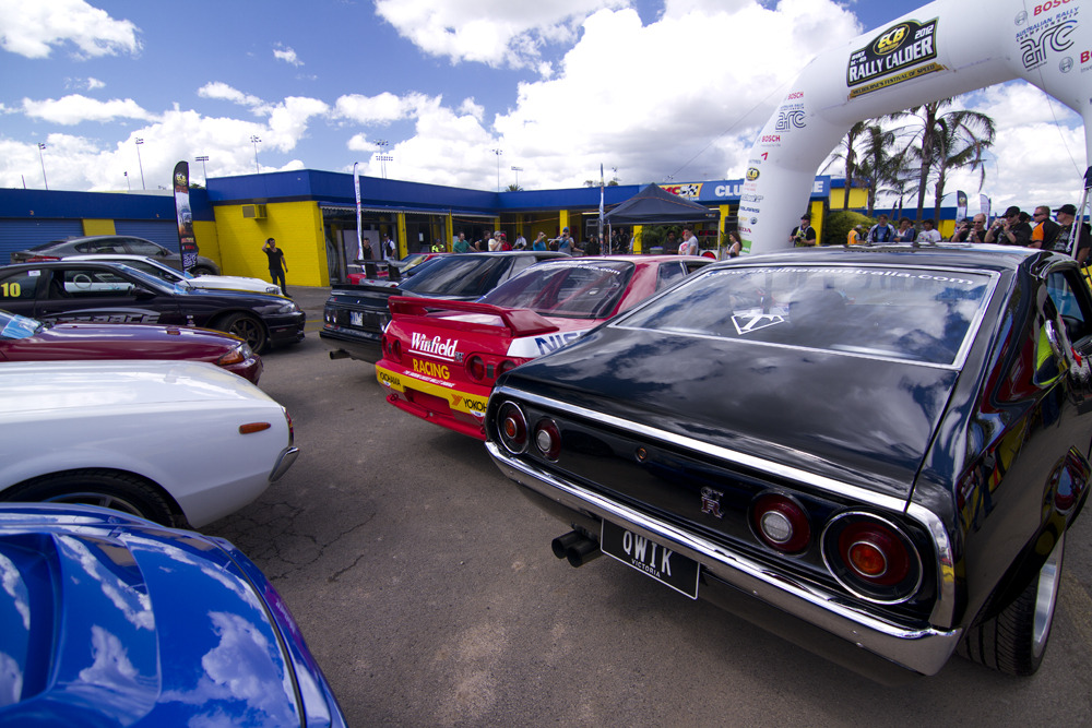

April 21, 201213 yr comment_387805 Rear tail light panel from sedan/coupe is not interchangeable, KID-K's is a sedan cut and shut job sedan is wider... Link to comment https://www.classiczcars.com/forums/topic/41457-terrys-project-240k/?&page=7#findComment-387805 Share on other sites More sharing options...
April 21, 201213 yr comment_387807 qwik now has the gtr rings on it, but still no centre badge....no cut and shut required, you do need re-drill some of the mounting holes, but no cutting or shutting...it isn't wider, the bumper bars are also interchangeable.... Edited April 21, 201213 yr by KID-K Link to comment https://www.classiczcars.com/forums/topic/41457-terrys-project-240k/?&page=7#findComment-387807 Share on other sites More sharing options...

April 21, 201213 yr comment_387810 Ah yes, my apologies, if I recall correctly it's the mounting holes on the sedan which are wider, correct? Link to comment https://www.classiczcars.com/forums/topic/41457-terrys-project-240k/?&page=7#findComment-387810 Share on other sites More sharing options...

April 21, 201213 yr comment_387813 if your referring to the 10mm nuts that bolt to the rear beaver yes, the boot on a sedan is wider but the chrome corner trims are narrower...Importmonster has a warehouse in Japan that your items are stored at until you release them.. Edited April 21, 201213 yr by KID-K Link to comment https://www.classiczcars.com/forums/topic/41457-terrys-project-240k/?&page=7#findComment-387813 Share on other sites More sharing options...
