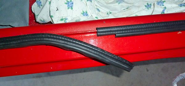

Some photos of the Precision Weather Stripping for the Door.
There are steel "U" ribs in the stripping that pinch the pinch weld. When you cut the stripping with a knife, try to cut between the "U" pieces.

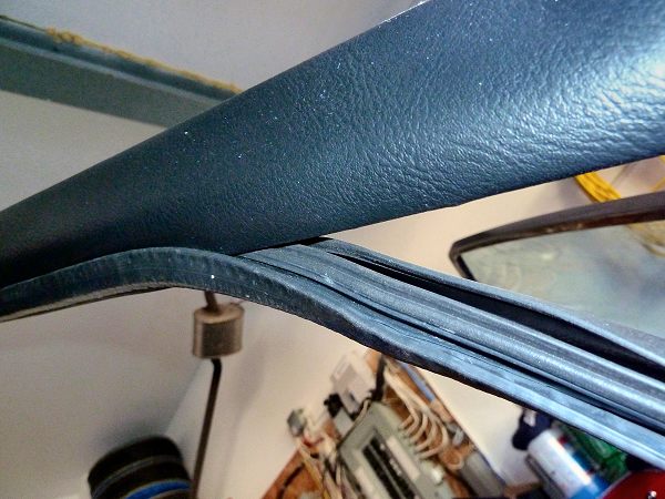

Here is a side view with some of the side rubber shaved to expose the chain of U clips.
