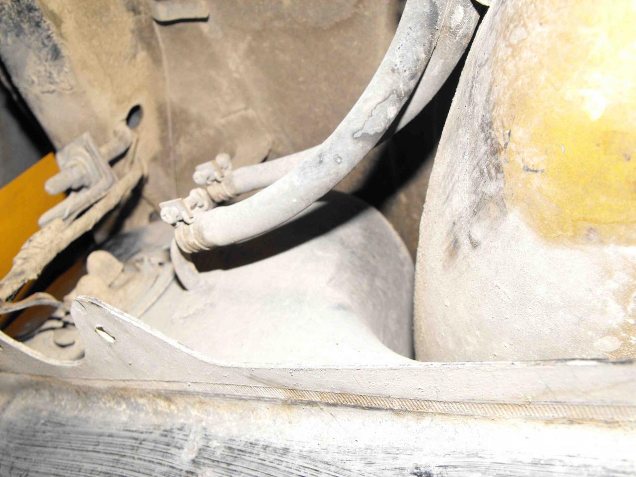

So I am getting ready to put my gas tank back on and pulled it from storage. I have been looking at information on this site about which hoses go where and realized that I am missing several hoses from the tank. My Z is an early model and didn't have the hose at the small end and didn't have the evaporation tank. There is the hose fitting on the far side and was expecting to see the hose fitting on the near side but there isn't one. Is this something common in the early cars? I had the tank sealed a few years ago but don't remember exactly what it looked like then. It has been sitting in a spare bedroom waiting until this day when the car is finally being rebuilt.

Carl,
Your fuel tank is correct for a car without the evap tank. They don't have the two upper hose connections on the front and back of the tank or the connection on the far left side. Here are some links to comparisons of the tanks from my 11/69 and 5/72 cars when I was refinishing them.
