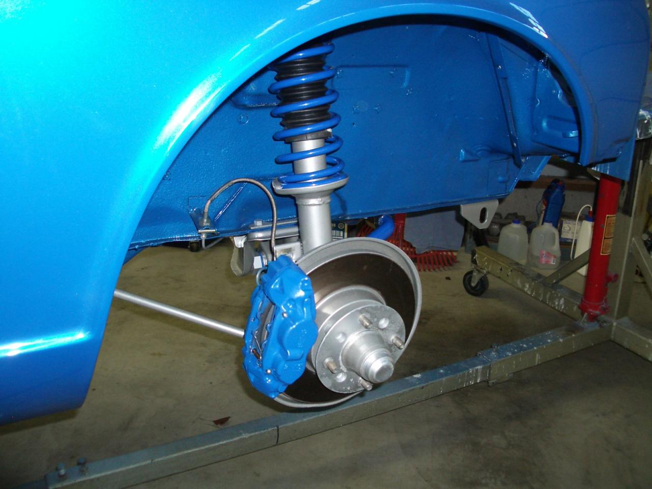

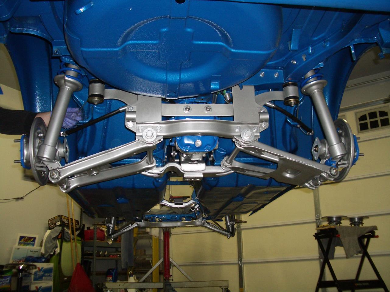

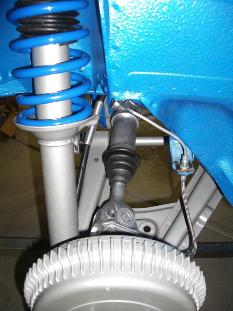

I had the entire suspension of my 260Z powder coated while it was on the rotisserie. All the items you mention were coated with the exception of the brake calipers which were sand blasted and painted with high temp brake paint. I also had the springs and sway bars powder coated. The cost was closer to $1000 in the area of Oregon where I live. My powder coater is very particular which is why I used him. Be uses garnet to media blast all the parts, then finish sands each part by hand before coating, resulting in a fantastic finish. Here are some photos of the end result on the car..
