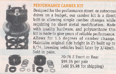

January 1, 200322 yr comment_21920 Besides the camber bushings you can also get a kit from MSA and possibly Ground Control that gives you a camber adjustment at the top of the strut without slotting the mounting holes. It is a block of urethane that is slotted that takes the place of the strut insulator on the top, as Rick states, that is what prevents much movement at the top of the strut if you just slot the mounting holes. I used the set-up on the rear of the IT car I had along with the adjustable bushings in the rear. I purchased it from Ground Control, and it looks to be the same set-up that MSA is now selling. 100 dollars(US) a pair for these and they will give about 1.5 degrees adjustment. For another 200(US) you can get the adjustable lower bushings and that should give you another 1.5 degrees or so. Here's a pic of the set-up from their catalog, so you get the idea of how easy it is to use. The next thing that would be the hold up for more adjustment would be the springs with this set-up, the spring would hit the inside of the strut tower. Link to comment https://www.classiczcars.com/forums/topic/4074-negative-camber/#findComment-21920 Share on other sites More sharing options...
