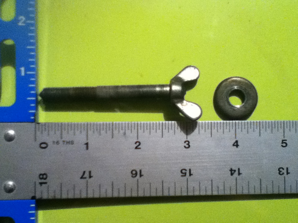

Anybody have a complete set they can lay out and shoot a pic of for the files here?
Anyone found these at NISSAN? At this late date I'd be surprised if they had them or even knew what we woeld be asking about.
Here's the wing nut off my 72 240z I believe the two on there are the same. What was the other bolt you needed?

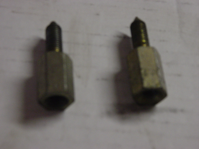

post-874-14150816074731_thumb.jpg Here are the special bolts that the wing bolts screw into.
The other 2 bolts that hold on the the air box are common 10mm bolts.
Marty
My current air cleaner ('73 version) has "special" bolts like the ones in Marty's picture. Would my existing bolts work with the older air cleaner?
