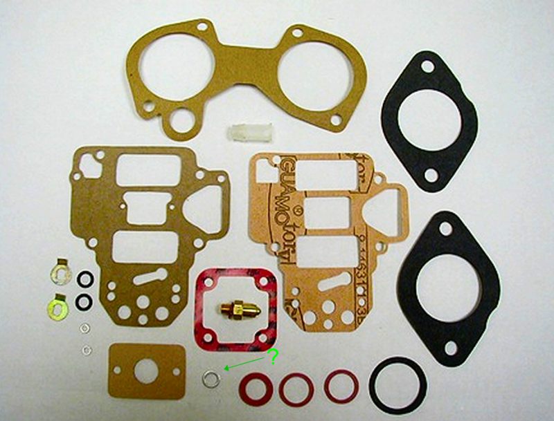

I am refreshing some carbs and the kit has a mystery washer that I can't figure out where it goes?
It is the single aluminum washer in this photo at the bottom.attachment.php?attachmentid=47676&d=1313871242

I just did this with my 42 DCOE carbs. The kits have become more 'general' and you don't use all of the parts. A tip though, you have to put the carb top gasket in place before you attach the float as the float doesn't 'drop' through the gasket, at least on mine.

Thanks, I am beginning to think the gasket may be for the needle valve as the carb kit had two bags, one had nearly all the parts and a small second bag had a needle valve and a fibre gasket. I am guessing that the two bags were from different mfgr's and two gaskets were provided for the needle valve... but I never saw an aluminum needle valve gasket as it will change the fuel height.
I got the kits at Weber Carb Direct so I'll take your advice and ring them.
The main body gaskets fit fine but I had to remove the floats before installing. There were actually a few different gaskets in the kit for different body castings/machinings.
