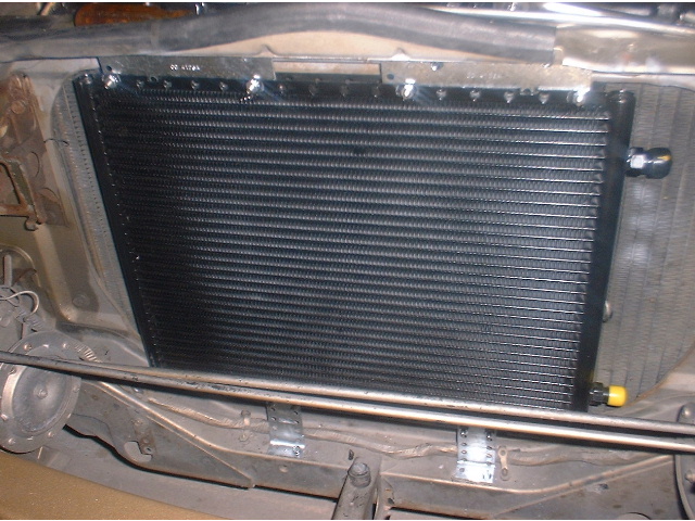

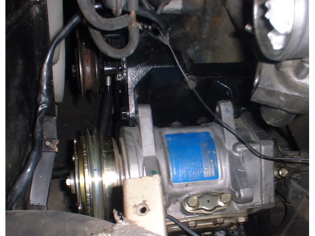

expense. here is my setup. im using a zx mount and later model hitachi compressor with aftermarket condenser.
[ATTACH=CONFIG]47661[/ATTACH]
[ATTACH=CONFIG]47662[/ATTACH]

I believe the damper pulley on my car would work just find with the 280z mount with little modification. Thanks for the website, most of the places I know of only sell a complete a/c kit.
