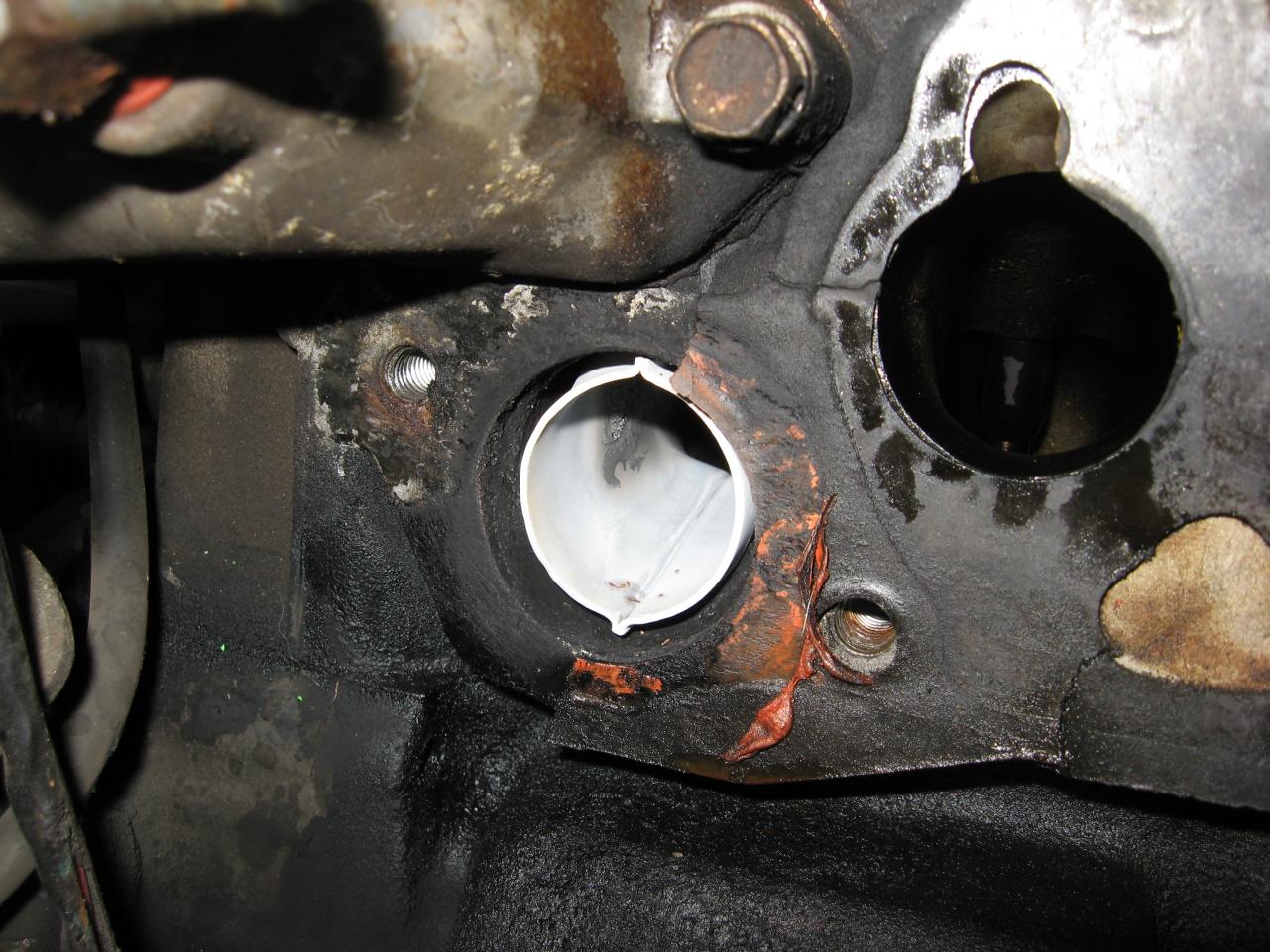

August 14, 201113 yr Author comment_364028 I got the manifolds removed today. The bolds and nuts seemed to easy to remove like they were not torqued down at all. the old gasket was in pretty bad shape, it looked as though someone in the past had removed the manifolds and reused the gasket damaging it in the process and there was a piece missing from cylinder one's exhaust. This makes me happy in a way as I feel I am doing this for a cause instead of a hunch. Edited August 14, 201113 yr by grantf Link to comment https://www.classiczcars.com/forums/topic/40399-intake-exhaust-gasket-help/?&page=2#findComment-364028 Share on other sites More sharing options...

August 14, 201113 yr comment_364040 Wow, congratulations! Yours was a LOT easier than mine. I'd recommend you replace all the fasteners, whether they look like they need it or not. I sprayed both sides of my gasket with this: http://www.google.com/products/catalog?q=copper+gasket+spray&rls=com.microsoft:en-us:IE-Address&oe=&um=1&ie=UTF-8&tbm=shop&cid=7438551903716389274&sa=X&ei=3ctHToDXC6ipsAKJypDXBQ&ved=0CC4Q8wIwAA# ... and then I thinly coated all the port holes on both sides of the gasket with this: http://www.permatex.com/products/Automotive/automotive_gasketing/gasket_makers/auto_Permatex_Ultra_Copper_Maximum_Temperature_RTV_Silicone_Gasket_Maker.htm I don't know what brand of gasket I installed. I ordered it from MSA, and it came in an un-labeled plastic sleeve. It looked reasonably substantial, to my untrained eye. Wow, if your gasket was as bad as you indicate, this should make a HUGE difference in how your engine runs! Link to comment https://www.classiczcars.com/forums/topic/40399-intake-exhaust-gasket-help/?&page=2#findComment-364040 Share on other sites More sharing options...
August 14, 201113 yr comment_364041 I used a Nissan gasket, no sealer, new studs from msa and put anti sieze on the studs and nuts. Link to comment https://www.classiczcars.com/forums/topic/40399-intake-exhaust-gasket-help/?&page=2#findComment-364041 Share on other sites More sharing options...
