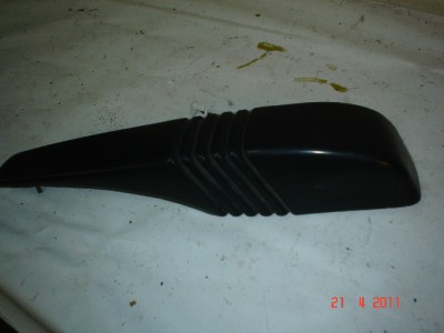

I''ve never seen the bumper rubber in person, but is it ACTUAL rubber or just a plastic insert?
I could make one out of resin if i had a mould, maybe even silicone so it retained the rubberyness, but it would be quite the experiment
I have one 60 bucks sent.
If you want it I will have to see about getting it off the bumper and ck cond .Or you can have the whole
bumper complete shocks and filler,both ends
60 bucks + ship i am sure it would be 100 shipping
from detroit.

Thanks! That's a quick reply and a generous offer...
I'll accept the left end rubber piece-dependent on the condition once you have a chance to evaluate it.

I just removed the damaged rubber, pretty easy-12mm deep-well socket, three nuts/ one bolt
I'm trying to avoid stocking parts that I don't need
The most common thing I've seen with the end pieces is that they crack in the 'bellows' part. If there was a way to rejoin them, then I could fix my one rear end which is starting to crack. Otherwise, you can find them on eBay, and occasionally they are affordable, but otherwise pricey for good ones.
BTW, it's not really really rubber, like a rubber bushing or window gasket, but a flexible plastic or PVC thing. Otherwise it would sag in the heat and fall apart after so many years.

I found a pricey one on eBay ( compared to Black Gold Man's offer but it was condition unknown
Yeah, you're probably correct that it isn't real rubber. Definitely not resin, i.e. hard. Someone on this site probable knows more about the composition of the materials of the 70's than I do.
FWIW, years ago, I repaired a split in the bellows using a material that was rubber-like, flexible,black-don't think it was actually silicone. Used a fabric patch from the back, like I was doing a fiberglass job. That way, I wasn't relying on the silicone type material for strength and the outside appearance didn't show more than a seam, in case UV and weathering changed the color of the patch material. Worked pretty good for years (not sure beyond that, sold it).
