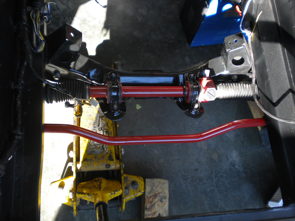

When I got my steering rack replaced, the guy removed the oil pan and put a board across the bottom of the block, and lifted the engine with a jack. I don't trust hydraulic jacks because they usually leak slowly, so you could probably stuff a frame support under the engine for a day or two, unless you have an overhead beam you can borrow.
