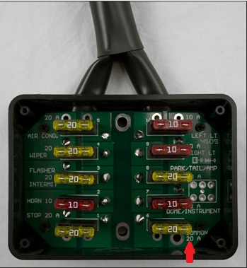

Car is a 240Z - 10/70 build date (Series 1)
What is the circuit marked "common" on the lower right of the
fuse block (shown with white arrow in photo) for? Does a fuse belong in this slot?? If so, what amperage?post-18487-14150815600865_thumb.jpg

Rob, the OP installed a replacement fusebox from Motorsport Auto. That's why he has the newer style fuses.
