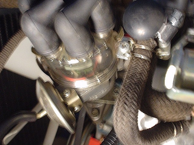

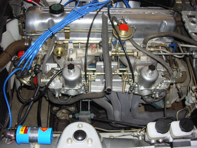

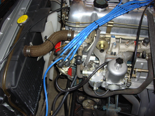

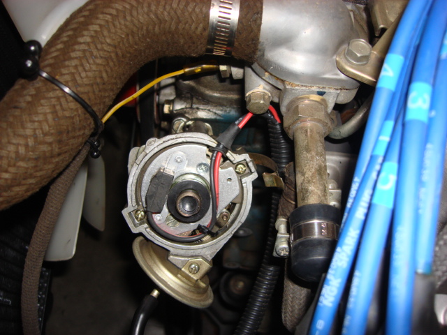

Post pictures of your engine bay/distributor. Be sure to include a picture of the distributor with the cap off, too.
trying to get a picture to post. What is the trick to posting the picture here.
Click on the Go Advanced button below this thread on the right side of the screen. After you do that, the advanced features should appear between the text box for a Title and the text box for the message. Click on the paperclip. That will allow you to upload files.

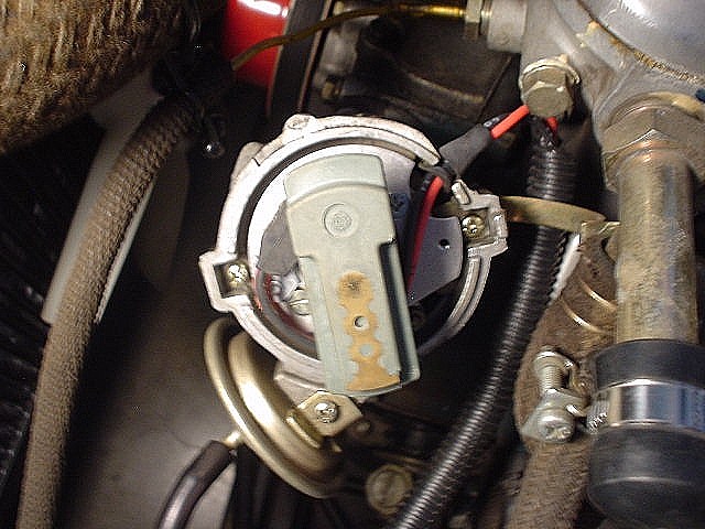

Can you post a picture of the other end of that split loom?

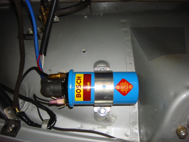

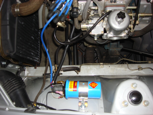

That's a Pertronix Ignitor. I agree, we need to see how it's connected at the coil, and what else is connected there.
WAG - the Bosch coil is overheating?? Maybe?
I see no ballast resistor, is that correct?
Correct I'm told this coil does not require one. According to Black Dragon catalog it says this coil is not for electronic ignition.
Edited by Arne
While there appear to be several versions of the Bosch Blue, they all seem to be about 3Ω rated, and so you're right, they should not need a resistor.
That doesn't change the fact that something is overheating and causing the car to stop. There's really only two choices here - the coil or the Pertronix unit in the dizzy.
