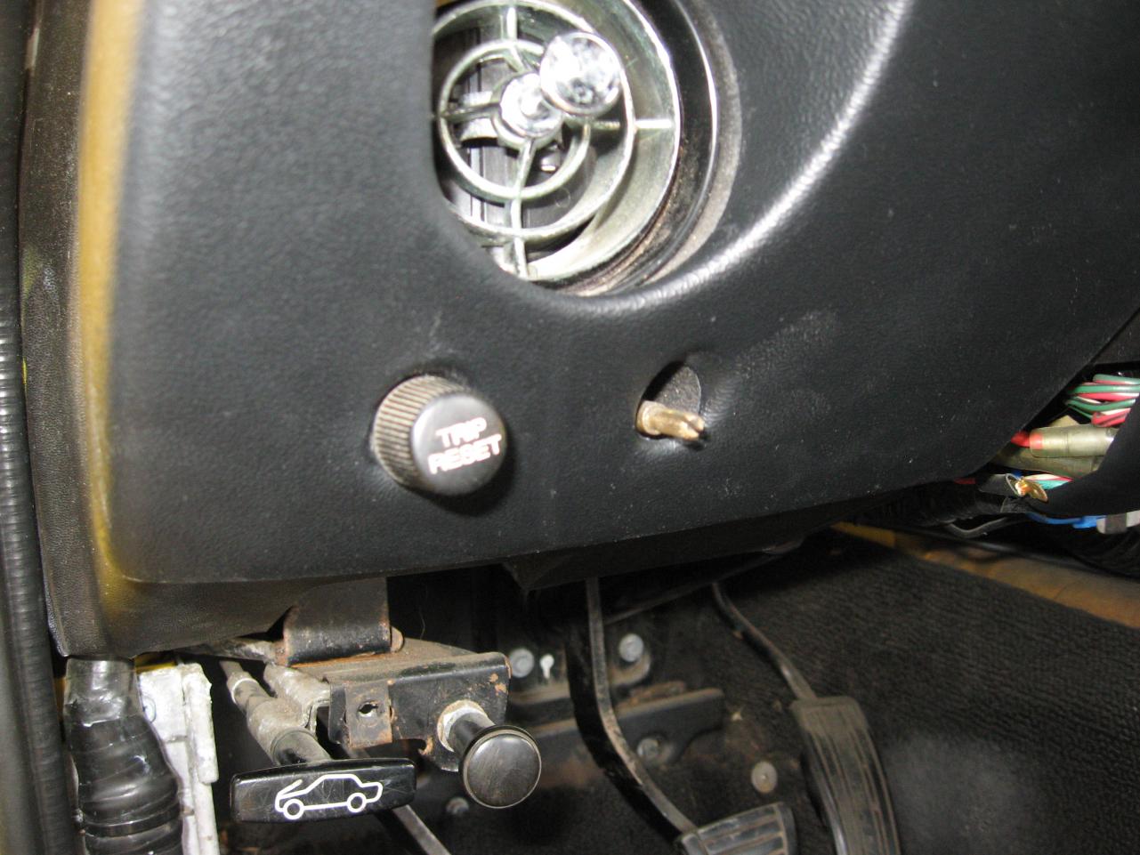

The car has no hidden damage and the dash is not distorted as far as I can tell. In fact, the dash is in good shape except for the top. I would use a half cap, but the PO used screws to hold the bottom of the old cap in place, so there are screw holds in the bottom portion of the dash that would show if I used a half cap. I think the shaft openings for the dimmer and odometer would like up if I could somehow get the cap to lay flush.
I've included a picture showing how the original cap was installed, which might give a better idea of my problem. As you can see, the PO just put the cap over the knobs which is make them useless and looks bad.

Looks like he didnt push the bottom in all the way, you can probably fix it yourself.. pull the cap off, removed the glue and reapply properly.
Let it sit out in the sun for a few hours to get soft first though.
I am not sure I see the problem, can't see till you remove the knobs and push it in all the way.
If you read the OP you will see he knows this. Just be nice to see the cap on without the knobs so we can see how for off. I purchased a full dash cap from MSA and have yet to install mine, it would be nice to see his before I find out the same problem.

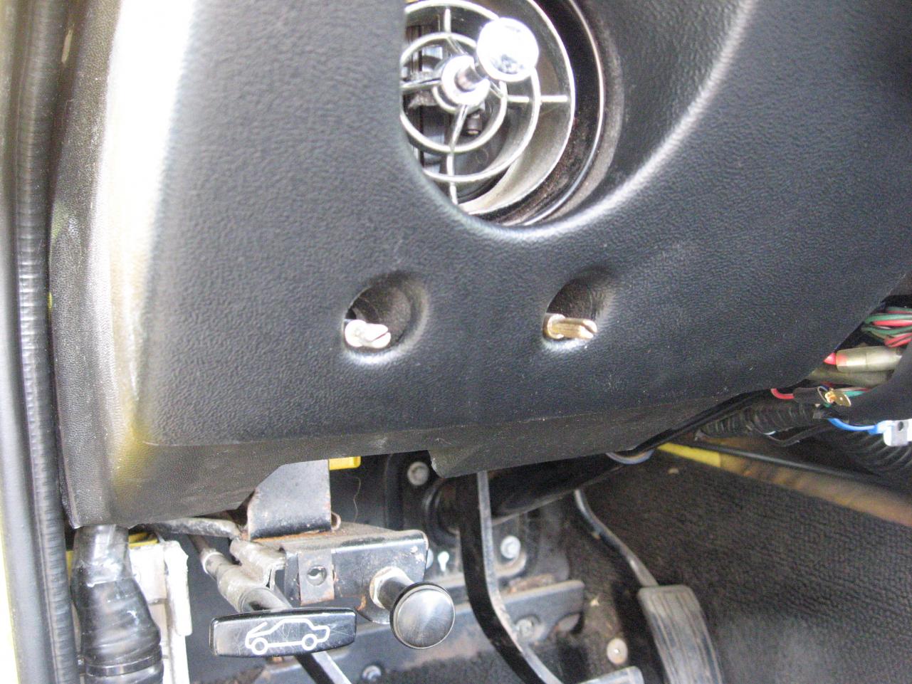

Ok just for fun I temporarily installed my dash cover, I used no glue just slipped it on and screwed down the defroster cover. I think I will leave it on for a while and let the sun and hot interior help it to conform to shape. glove box is a little sticky and I see some misalignment here were the two knobs are.
Is this close to what you are experiencing? I could slip the trip reset knob on but it is rubbing. I did notice there is some room to adjust the knobs and I think before I permently install the cover I may heat some areas up and conform them a little closer to were they need to rest. Overall not a bad fit but not perfect.
Yours fits way better than mine! When you ordered yours, did you have an option to specify a deep cap, vs a standard one? The fact that your part number doesn't have a "D" tells me it is probably a standard cap. This may be my problem. On mine, the gap between the edge of the cap and the dash, is about 3/4-inch at the bottom edge, just below the knobs.
When I get a chance tomorrow, I'm going to take a couple more pictures so you can see in detail what I'm trying to describe. I'm also going to call Accu-Form and see what they have to say. I was under the impression that both Palco and Accu-Form used the same original molds, but I may be misinformed. The part number, 303 is the same for both companies, which is kind of a strange coincidence. The "D" supposedly signifies the deep cap. I really hope I'm wrong, because in that case I'd return my Accu-form and purchase a Paco in a heartbeat! When I talk to Accu-form, I'm also going to ask for some clarification on the difference between the deep (303D) and standard caps.
