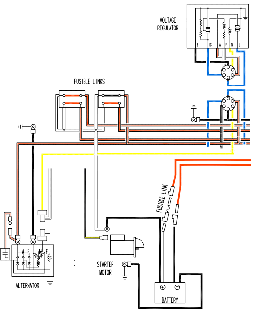

You can try cleaning the yellow sense wire contacts. It feeds back the battery voltage to the regulator and sets the target set point voltage. If the contacts are bad or loose then the feedback does not work.

I think there is a bad wire or connection in your circuit that is preventing the alternator from knowing what the battery is doing.... the alternator is supposed to work with the battery as a team and the yellow sense wire is how the alternator knows what the battery is doing.
It is also possible that the fusible link is current limiting the output of the alternator. It could be corroded.
Two 70watt headlight bulbs will only draw ~11 amps so the alternator should be able to handle that no problem.
Try this:
1. Connect a new wire to the "S" connection on the alternator and connect the other end to the +pos post on the battery. If this works then your sense wire in the harness and its connections need to be refreshed.
2. Clean all +12V cable connections between battery and alternator. The path is:
- Battery to starter
- Starter to fusible link
- black fusible link
- fusible link to alternator
You can check the wiring path interconnections on this drawing: http://www.atlanticz.ca/zclub/techtips/wiringdiagrams/F77ZCAR-WIRING1.pdf

A hot fusible link happens during an overcurrent condition. Check & clean all your fusible links. Replace the bad one. Courtesy Nissan does have the fusible links available.
Heating is due to current and resistance. The resistance of a fusible link and connections should be ~0 ohms therefore the heating should be ~ 0 Watts however if the connections to the fusible link are loose and/or corroded.... or the wiring to the bottom of the fusible link holder is corroded then this adds resistance and, in turn, heating.
Heating is proportional to I²R where I is current and R is resistance. As mentioned your lights draw ~ 11 amps however the resistance of the link should be ~ 0.01 ohms so the radiated power should be ~1.2 W
If the resistance of the fusible link was increased to just 1 ohm due to corrosion then the heat would be ~ 120Watts... try holding your finger on a 100W light bulb to get an idea of that much energy.
